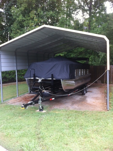

by Capt Sully
all I do is park it. take out everything that might freeze, add some fuel treatment, keep the on-board battery charger on.
in the barn-3.jpg (141.35 KiB) Viewed 5620 times
