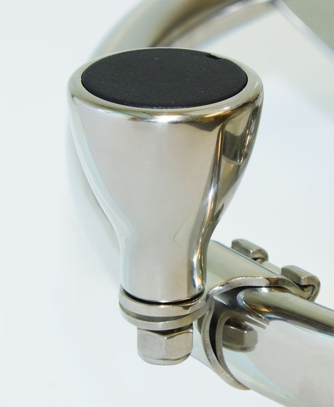

One of these I find helps a lot in tight places.
- knob.jpg (39.29 KiB) Viewed 2142 times
Re: How to free up a stiff motor bracket?
Great minds think alike, I just ordered one yesterday.RcgTexas wrote:One of these I find helps a lot in tight places.

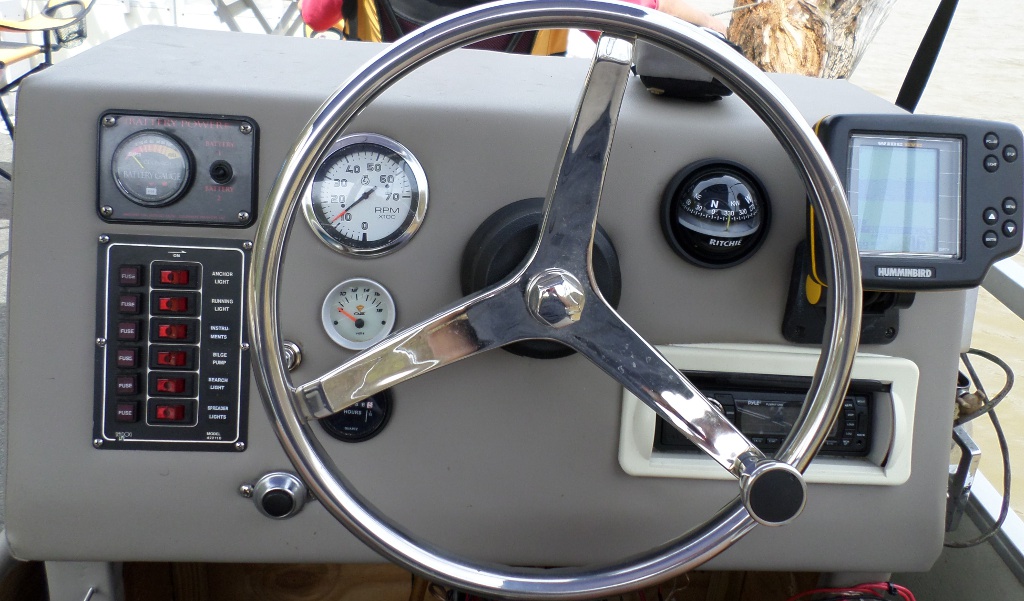

Crank knobs are very handy especially at low speed handling. I added one when i did my rebuild.
- compass installed.JPG (235.75 KiB) Viewed 2035 times
