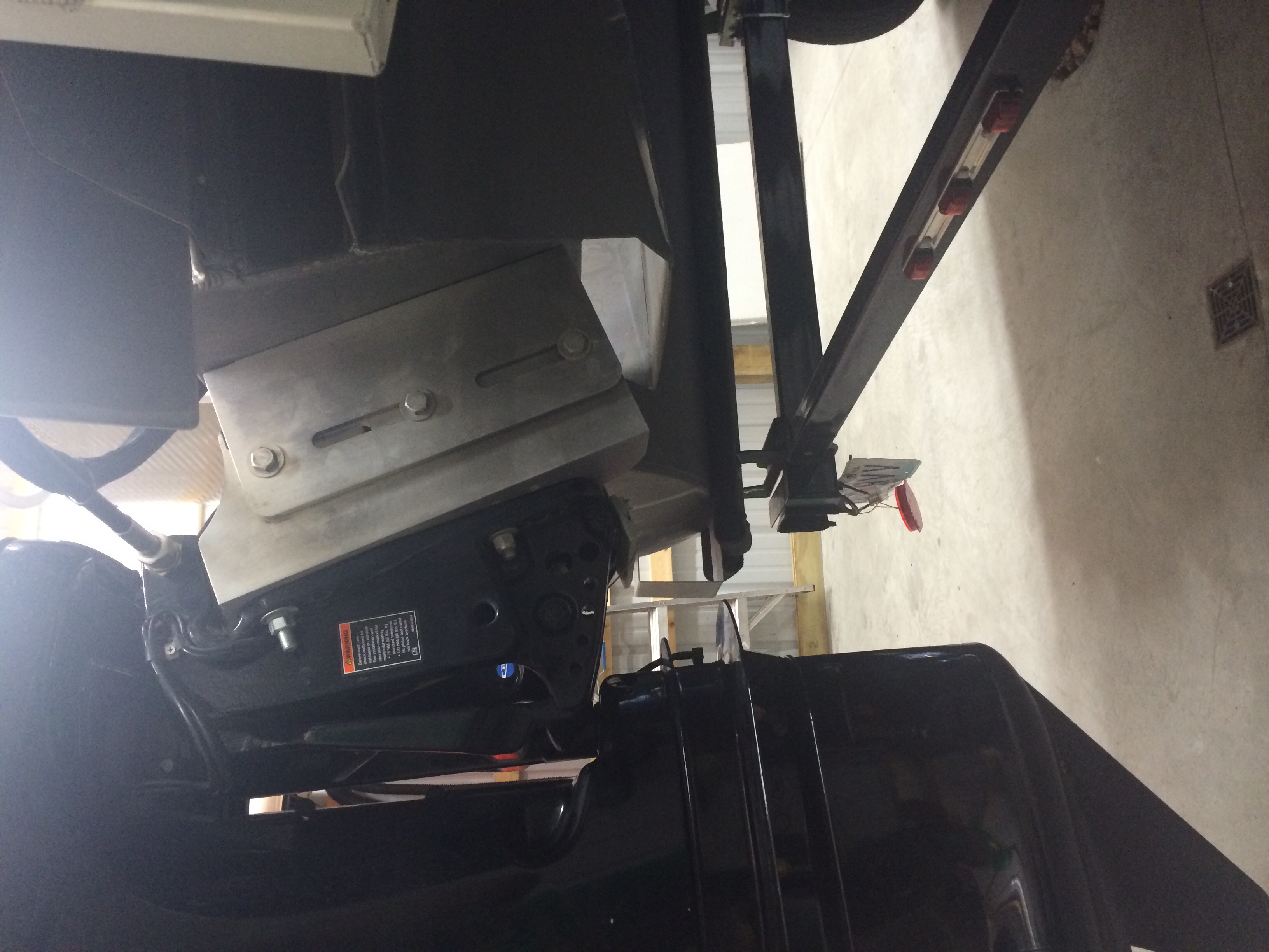

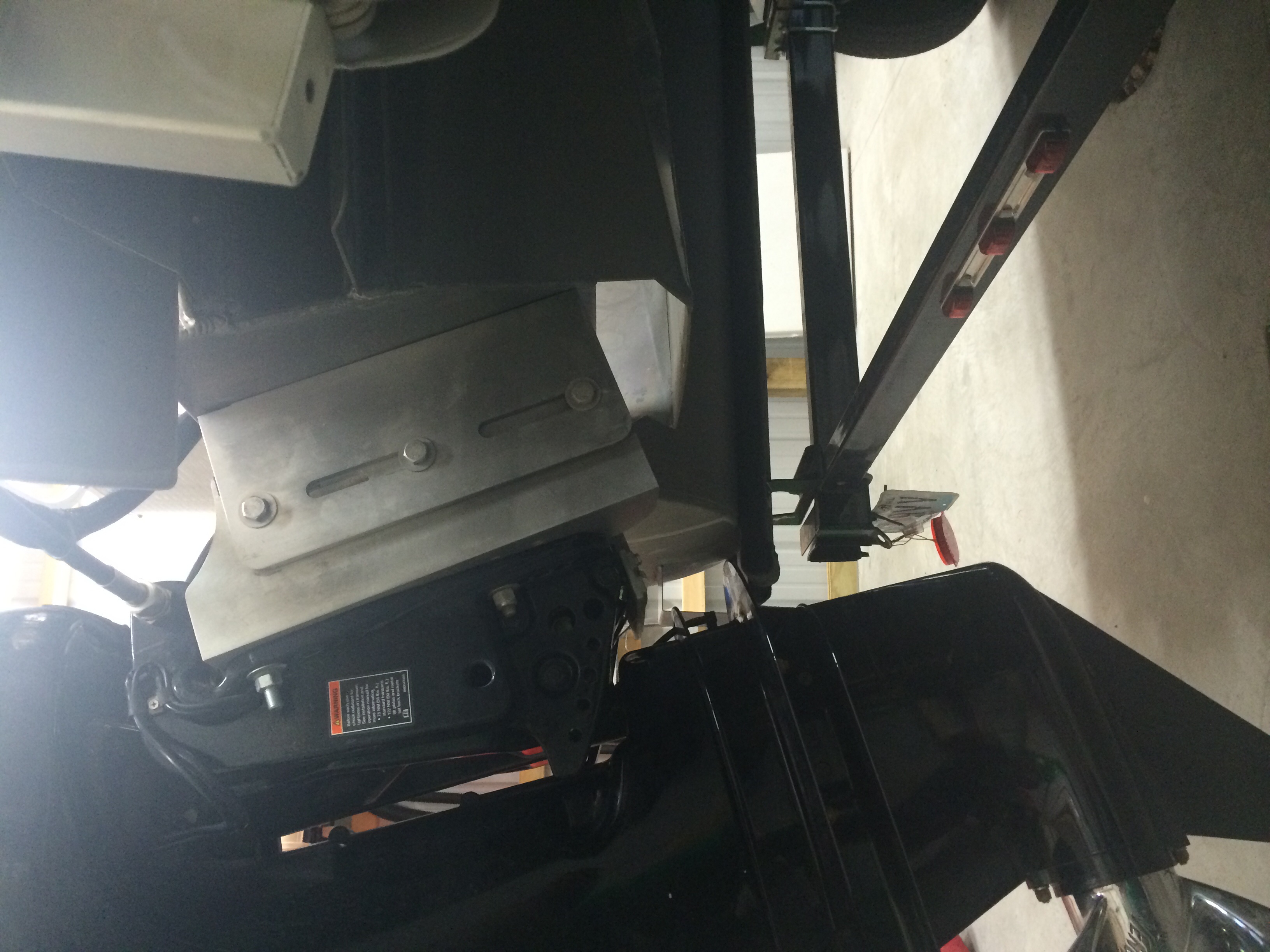

#8 Post by tottav » Fri Sep 19, 2014 4:47 pm
Here us a couple pics

#9 Post by RcgTexas » Fri Sep 19, 2014 5:41 pm
Well you were right the motor is all the way down. Wish you could lower the motor and then raise it by adjusting the jack plate.
