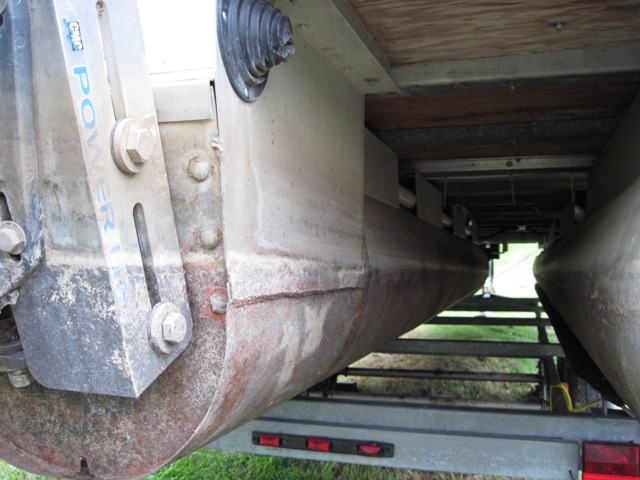

The aluminum angle was added to stop the motor mounting bolts from settling deeper into the transoms plywood.
This is the rear view of a party hut transom. The aluminum skin is relatively thin and IMHO there is no way it would hold up unless backed up by something substantial enough to dispense and carry the load. 4" Channel by itself just ain't up to the job. Now maybe with some plywood..

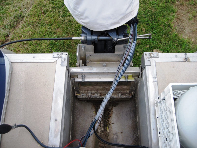

This transom is 1/8 plate with 3 inch channel across the top and mid where the bolt holes are.
Granted he may need more than just channel but in my opinion he doesn't need wood unless he wants wood. It came with wood so it will do just fine. Channel will last and weather better. To put channel he will need a little plate and some welding but in my opinion he would be better off. just
