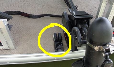

Re: Is it OK to tie the anchor to the rail of my pontoon boat?
We installed this tie-off system on the bow, next to the trolling motor. Run the line thru this jam cleat, done. Idiot proof for all the not-nautical people on your toon. Think it came from Overton's.
Even though I read your post I was looking at your picture thinking what the hell is that next to the cleat it looks like a dam scud missle.....landlockedsailor wrote:We installed this tie-off system on the bow, next to the trolling motor. Run the line thru this jam cleat, done. Idiot proof for all the not-nautical people on your toon. Think it came from Overton's.
