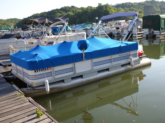

I had a cover made a few years ago and ended up with 6 poles to keep the sag out, its been good since. had to add 2 in the front corners.
- slip 1.JPG (154.5 KiB) Viewed 2308 times
