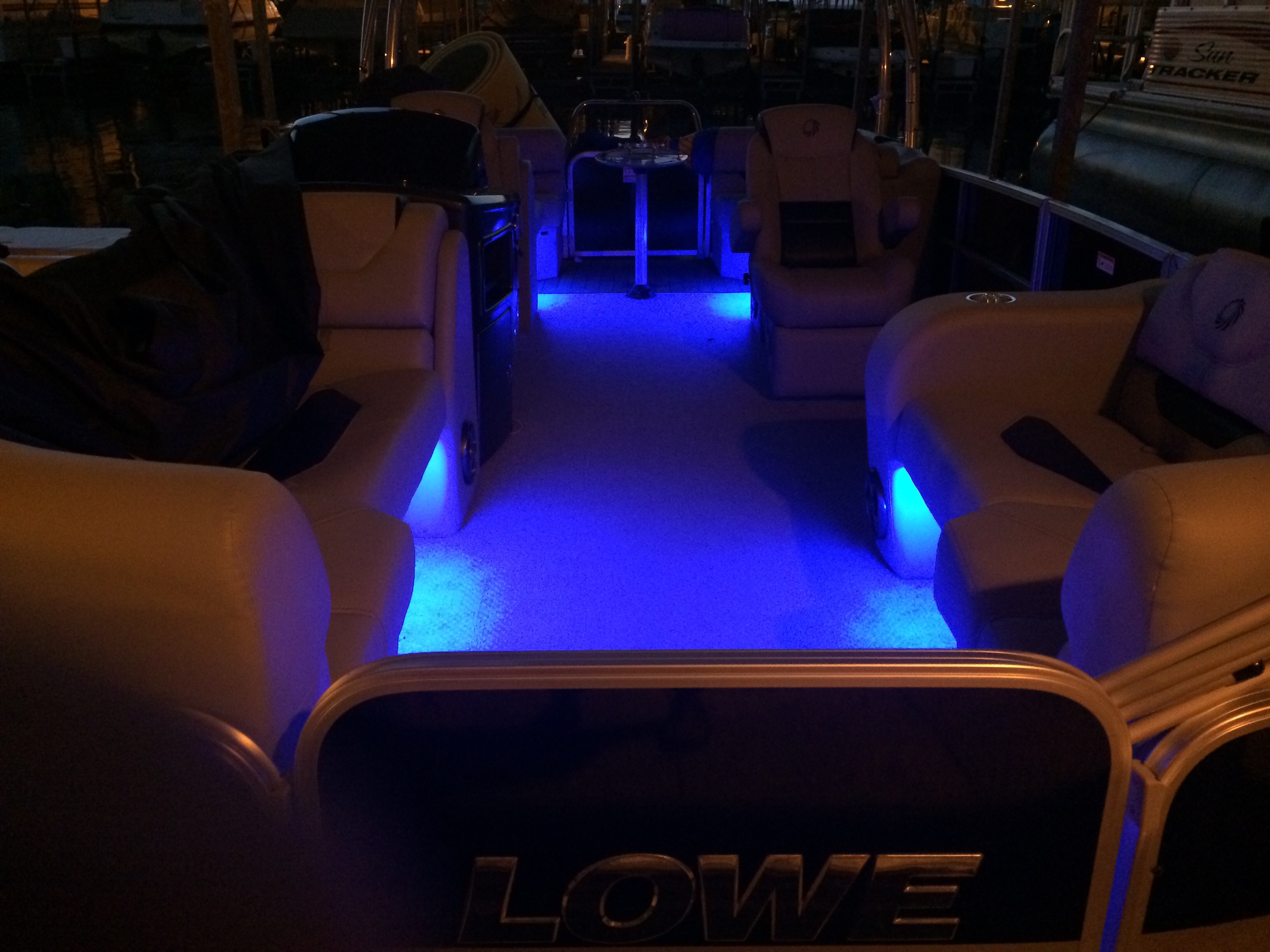

Re: Underseat/Interior LED's?`
I bought these at Academy Sports. http://www.academy.com/webapp/wcs/store ... h.F2caglPZ
They are 27" strips that mount in a channel. They can be trimmed down if needed, I had to cut a few inches off for my shorter bench. I just unhooked my factory courtesy lights and wired these in to that existing switch. Super easy and I couldn't be happier. They match my underwater led's perfectly.
