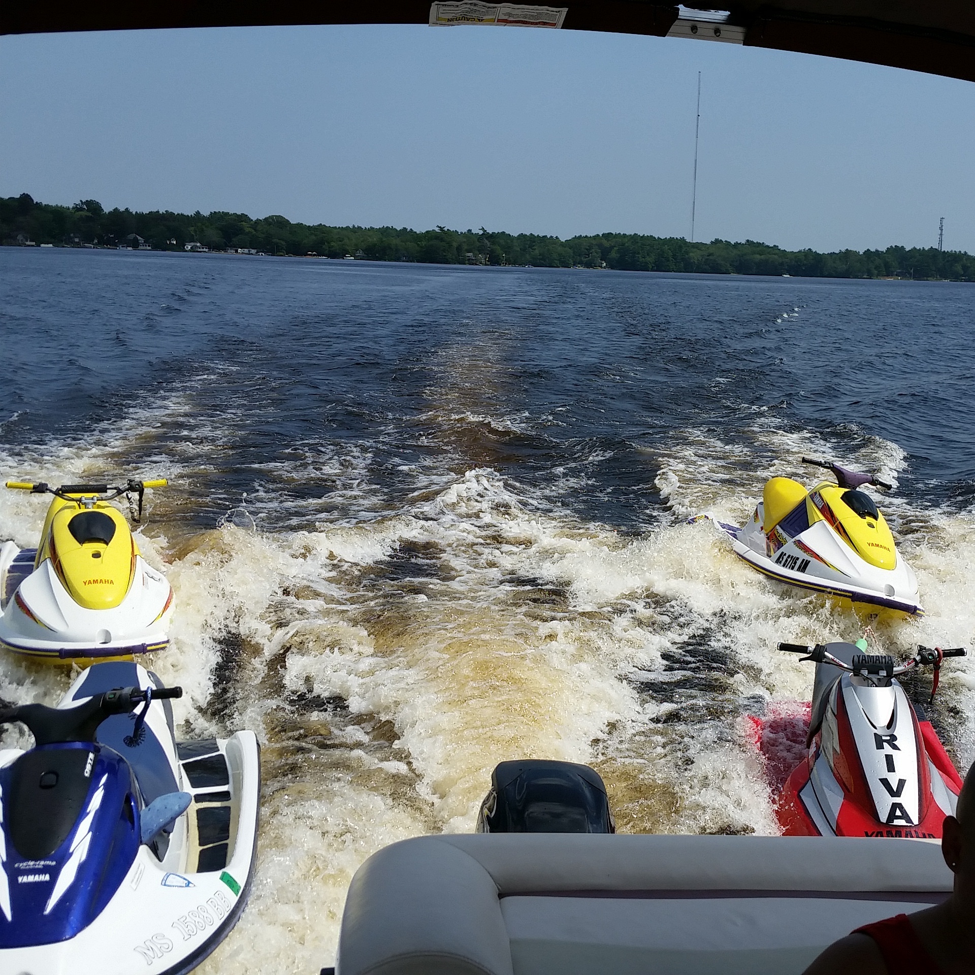

#15 Post by Xscash » Tue Sep 08, 2015 4:33 am
dragonx wrote:Has anyone considered large pvc tubes to store long narrow objects like tents, umbrellas, chairs etc. on the underside of the deck outside the pontoons? You could cap both ends and secure to the mounting tabs for cross supports?
We tow 4 jet skis every time we go out. I made a 3 point hitch for each pontoon. I am installing the 6" tube with caps under the boat to store the hitch rods. I'll let you know how I make out.
