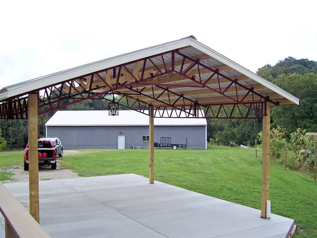

#3 Post by Bamby » Thu Jan 15, 2015 2:40 pm
We purchased a piece of riverfront recreational property ourselves late last fall and I've of late been contemplating what we're going to do with it. We can't actually build on it due to flood plain regulations so we're thinking of getting a shelter tall enough to cover a camper year round with enough additional width to also store the boat under it in the off season.
Build a Barn.jpg (112.2 KiB) Viewed 2246 times
This is the one I'm seriously looking at though I'd need one wider and longer than this 24x20x12 pictured (3000 complete less concrete). Maybe something similar would also work for your needs.

#4 Post by RcgTexas » Thu Jan 15, 2015 6:33 pm
Those metal trusses with wood frame and tin roof really look stout. Is that home made or built locally?

#5 Post by Bamby » Fri Jan 16, 2015 5:27 am
RcgTexas wrote:Those metal trusses with wood frame and tin roof really look stout. Is that home made or built locally?
It does appear sturdy doesn't it. I ran into this on a Craigslist posting and there is also a running list of models and styles available on a Facebook page. So as to you question I'm can't be sure at to weather this is a reseller or a manufacture but they ship out of southern W.V. near MH Hawker's neck of the woods.

#6 Post by sunedog » Fri Jan 16, 2015 5:46 am
Bamby wrote:This is the one I'm seriously looking at though I'd need one wider and longer than this 24x20x12 pictured (3000 complete less concrete). Maybe something similar would also work for your needs.
And if you want to know how much concrete you'll need so you can get a quote, the formula for a 3.5" thick slab is length X width / 81. So, for example, a 20 foot by 30 foot pad would take 7.4 cubic yards of concrete (20 x 30 / 81 = 7.4). I've been paying around $104 a yard for concrete lately. Not sure how much forming and finishing labor is up to. (My company does their own labor.)

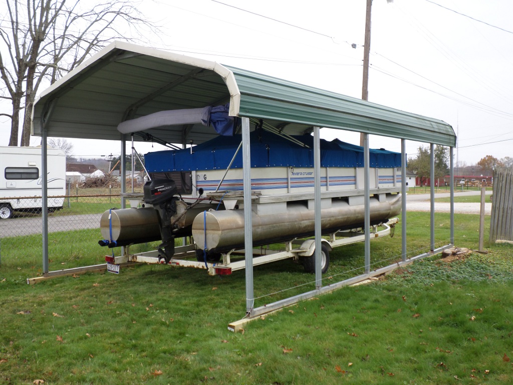

#7 Post by MH Hawker » Fri Jan 16, 2015 7:17 am
Whats the co name and ill take a look. I was happy to get mine under a carport this year.

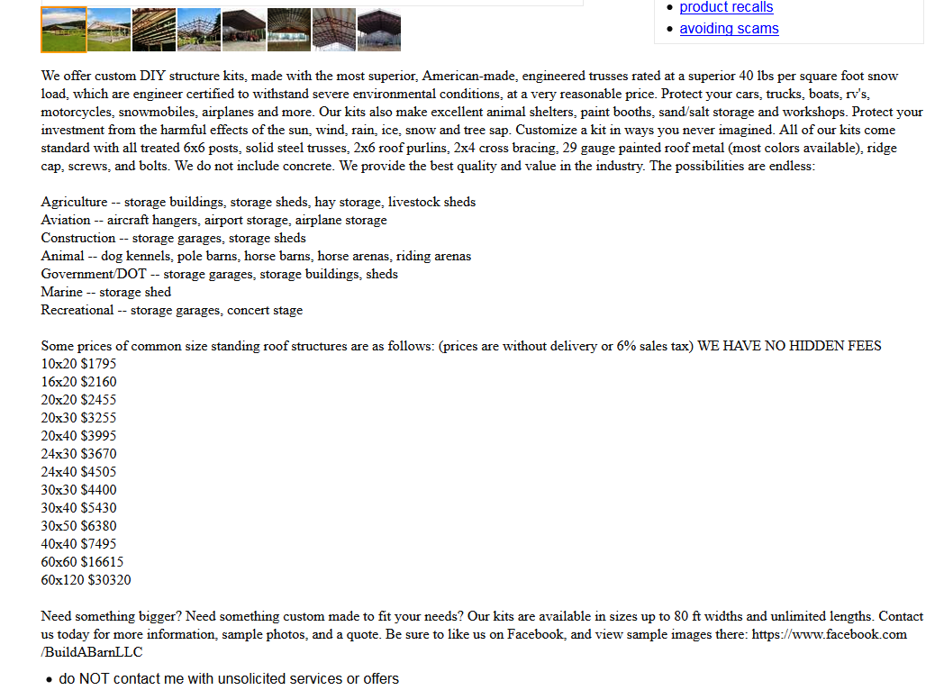

#9 Post by Bamby » Fri Jan 16, 2015 8:18 am
MH Hawker wrote: Whats the co name and ill take a look. I was happy to get mine under a carport this year.
Here's a copy of most of their Craigslist posting:
And here is their site on Facebook: Build A Barn
I also would like more insight before I commit to this myself but on the appearance of the photo's it could be perfect for my needs.
