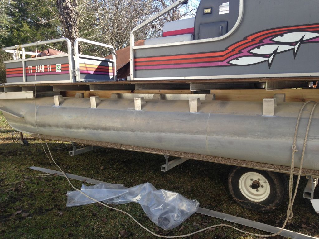

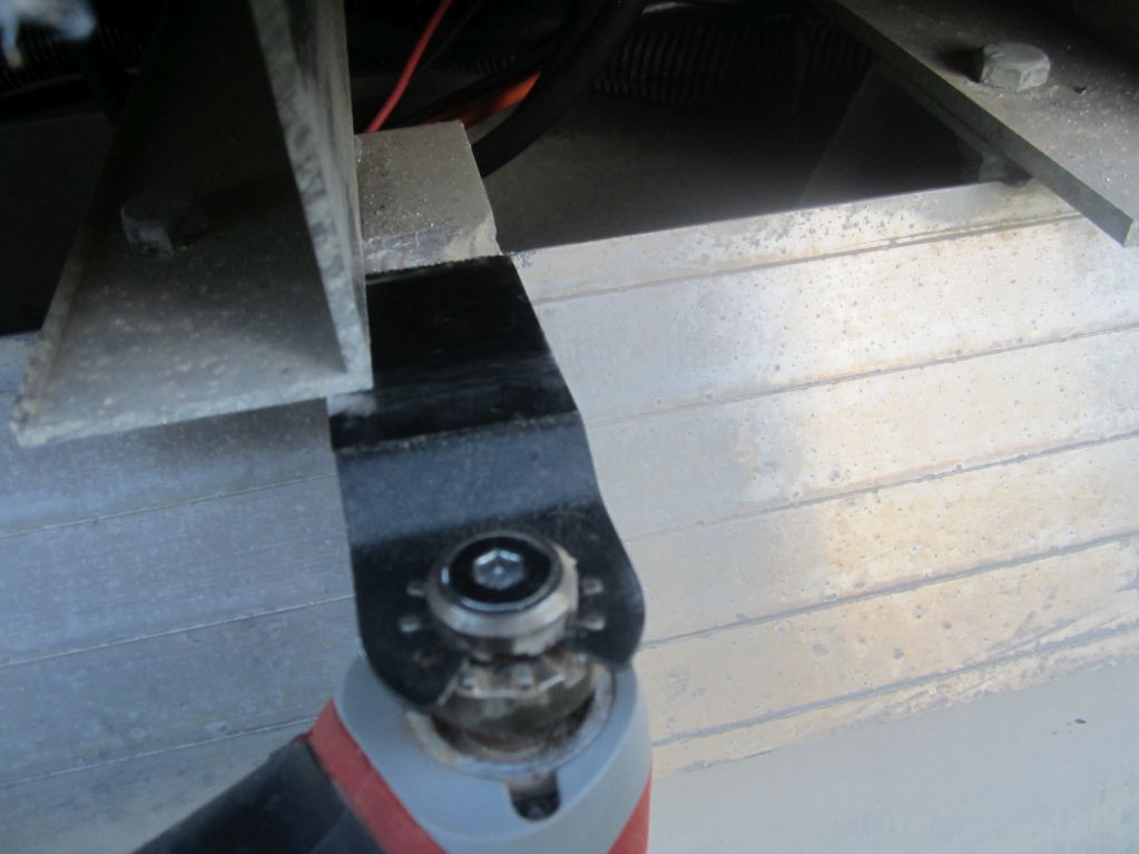

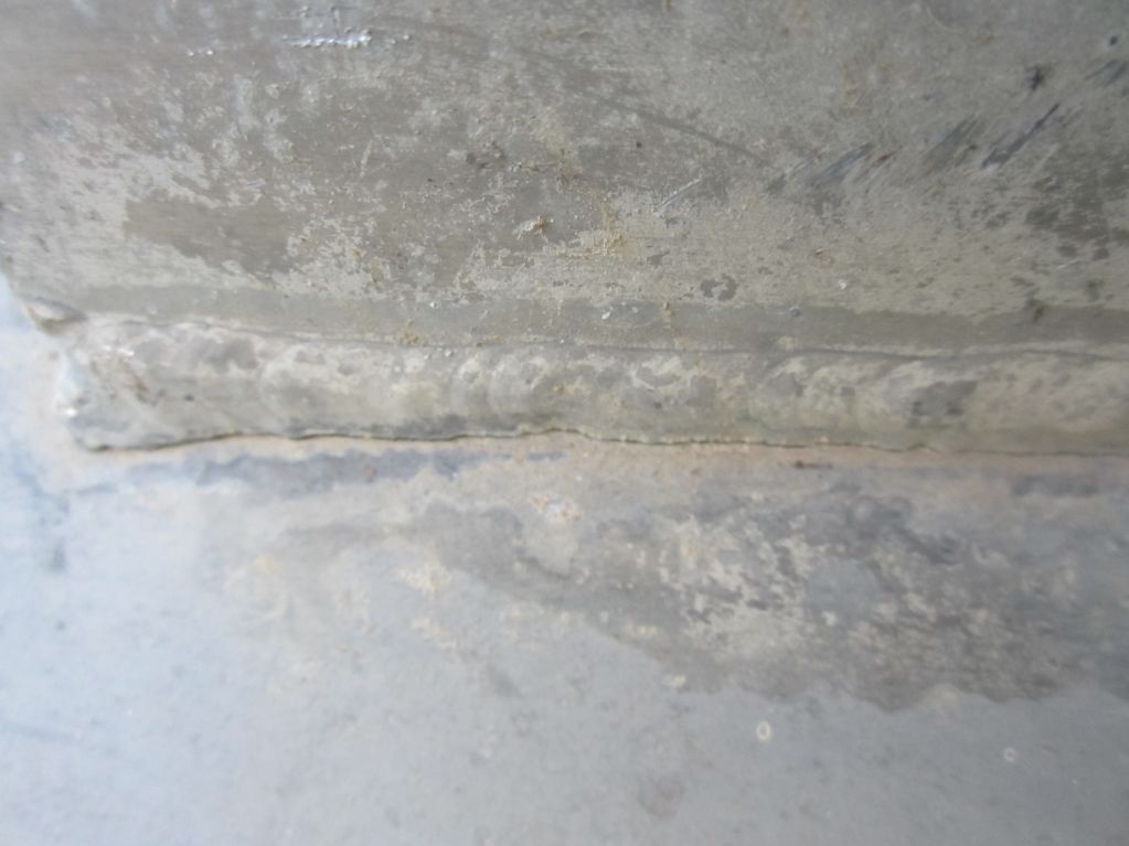

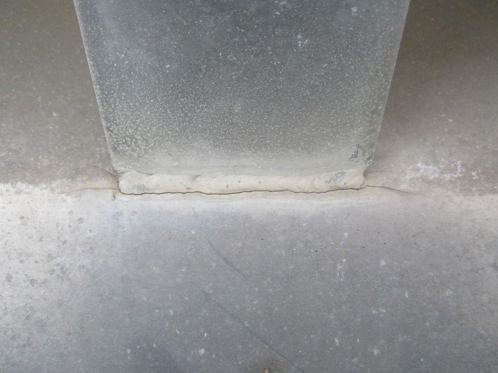

I got the old trusty multi tool out and went to work weakening the welds on the log mount covers.
After a lot of noise...

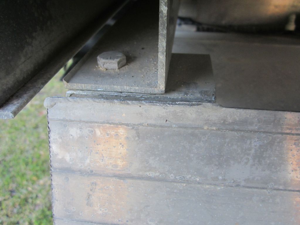

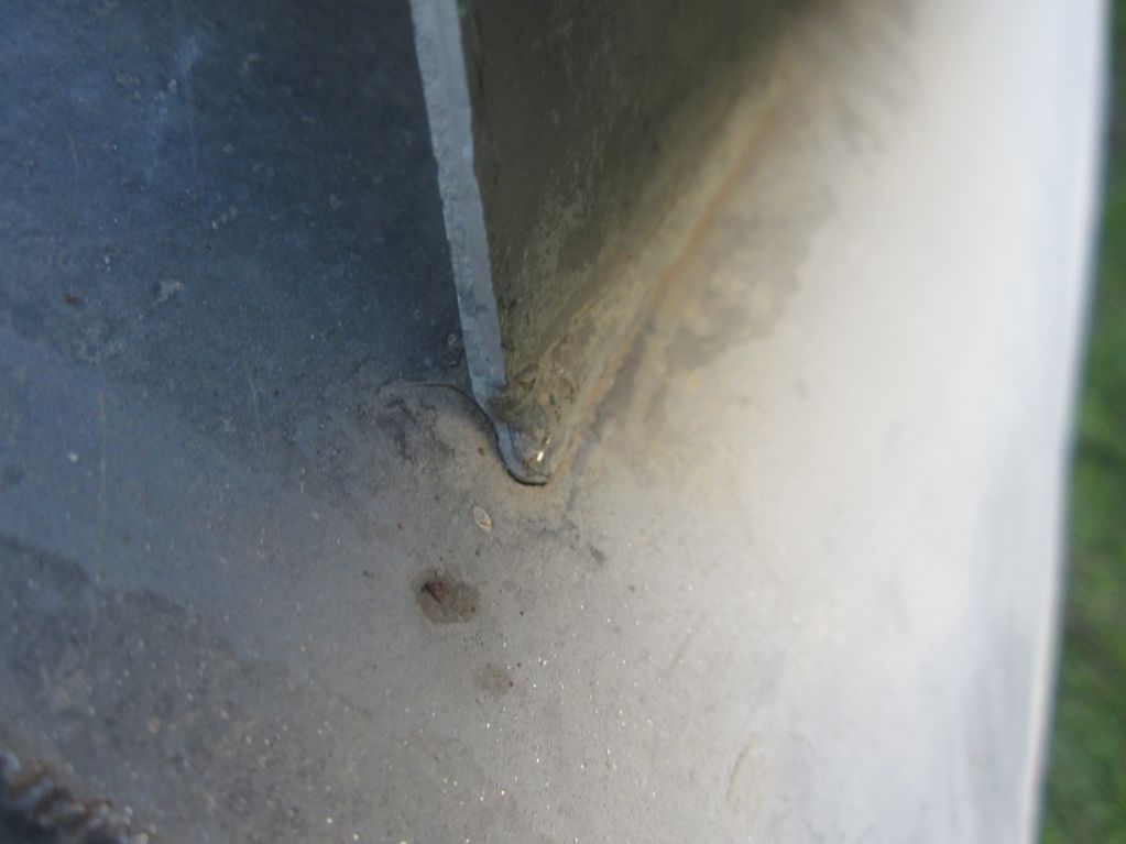

A little working back and forth, here's the old girl with her skirt removed.
Well, look what we have here.

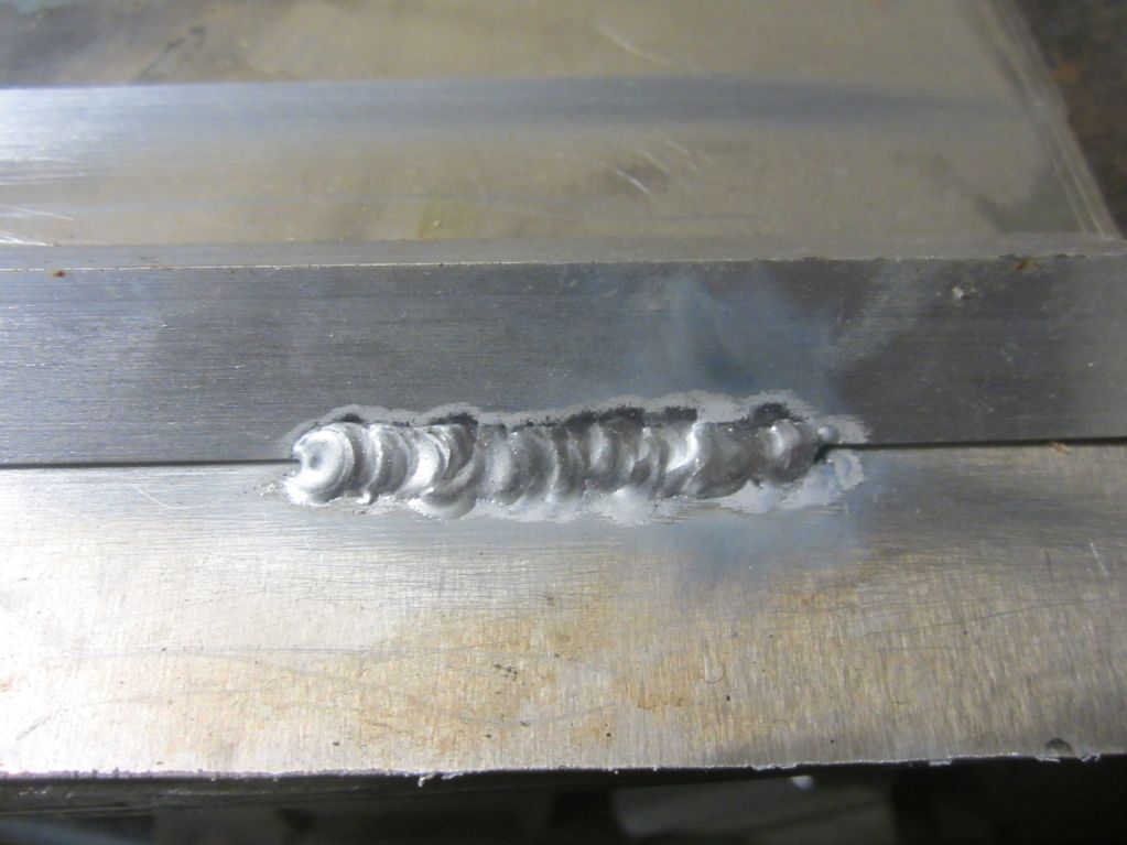

Well dark fell so I went into the shop, poured me a glass of top shelf Tequila, grabbed a couple scraps of thin aluminum and seen if I could run a bead.
Guess I need to brush up a little...

Weel you could call it a gorilla weld. ugly and strong! but with a little practice you will have it down. that's not that bad.
I like the center pod. kinda like mine only it has no tank(brain fart) and is air tight.

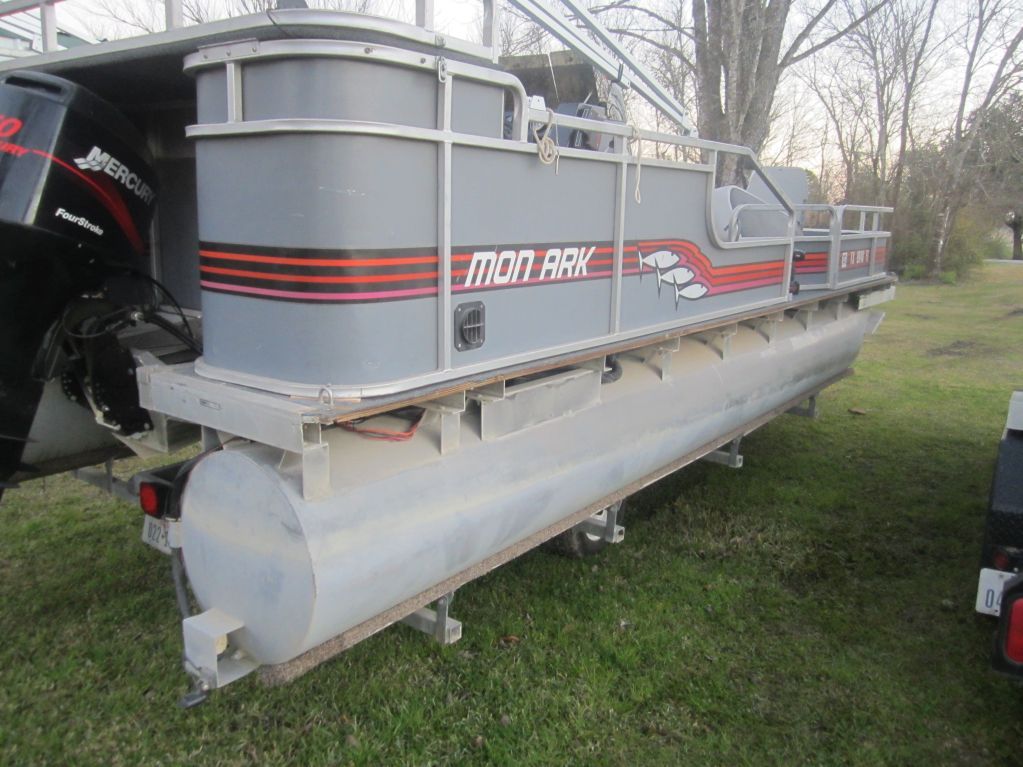

Well, pod arrived and looked just like the one on the seller's site. No dings and well packed.

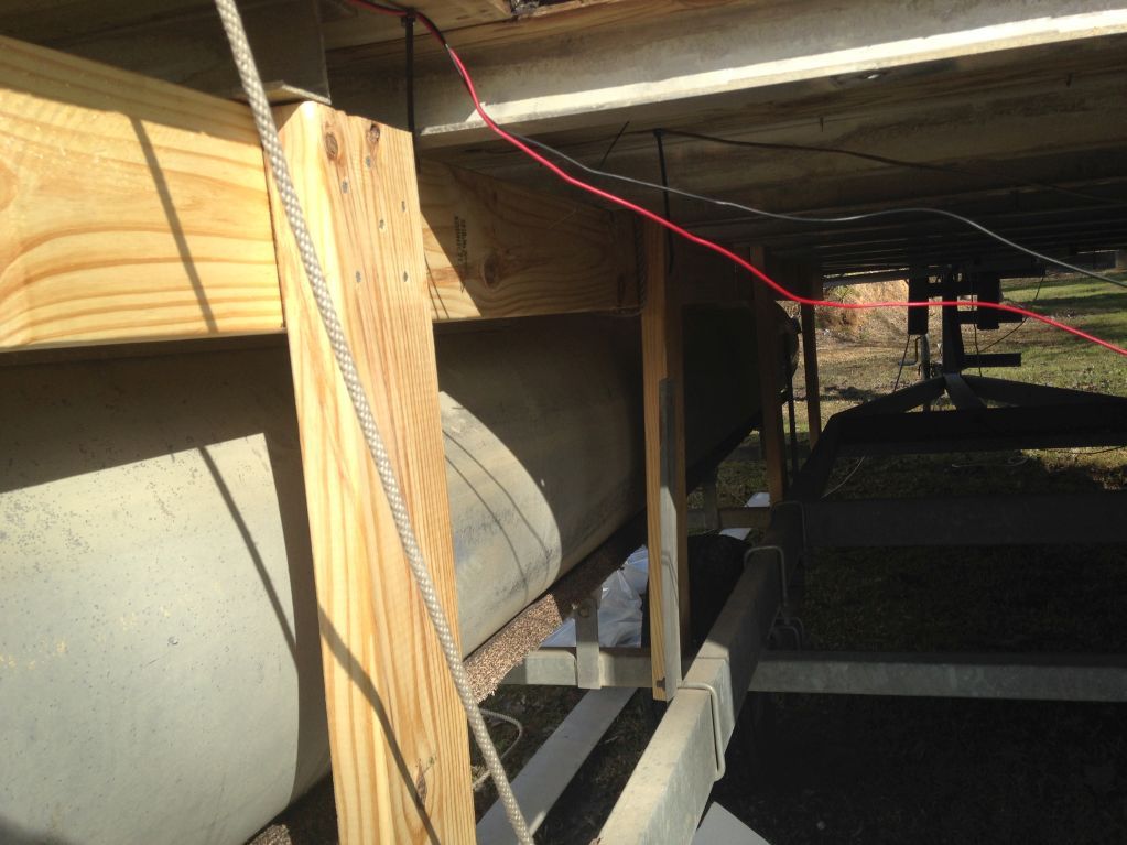

Nephew came buy so we got busy and pulled the motor and pod.
Unbolted the port log and built some cripples to support the deck.
Log #1 ready to take into the shop for cleanup and repair.
