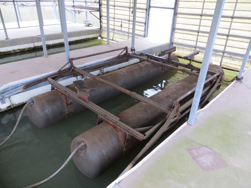

My dad had an older '80's model HydroHoist lift that he used to use for his open-bow boat. For about 6 years, the lift would not keep air in the tanks so they would sink after about 3 days. Finally got the nipples in both tanks replaced and the lift holds air perfectly now. I contacted HydroHoist to see if this old lift could be modified to be able to hold our pontoon boat. I was told since this older style had the lower pittmans that we should be able to modify this lift with no problems. So I had some steel brackets made that I installed on the lift and then added bunks. What I didn't take into account was the weight of the boat at the rear and how much lower the back of the boat would sit. So I have created new brackets for the rear bunk supports that will raise the back of the boat higher out of the water (the pontoons were completely out of the water already, but the skeg of the motor was still in the water unless I trimmed the motor up). As soon as I finish buffing out the pontoons on the boat, I'll put it back into the water and test out the new angle of the bunks on the lift.
Here's a few pictures to give some visuals to what I described above.

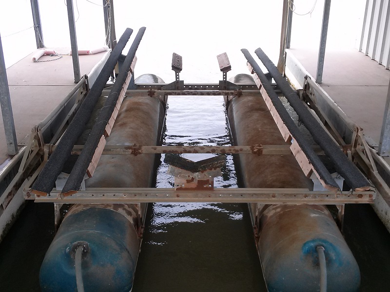

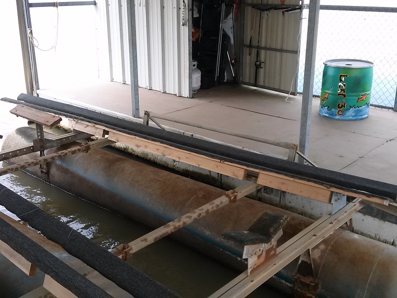

- Here's what the lift started out looking like after fixing the nipples in the front of both tanks.
- lift_before_lr.jpg (158.33 KiB) Viewed 7409 times

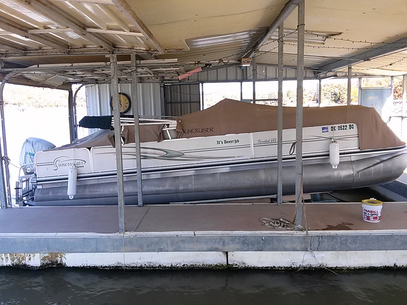

- This shows how the boat would sit unlevel on the lift.
- unlevel_lr.jpg (191.93 KiB) Viewed 7411 times
- This shows the height of the old rear bunk support -- it's 8" tall - same height as the front bunk support. It's lower than the rear bunk support when this lift was used for the open-bow.
- old bunk placement_lr.jpg (172.89 KiB) Viewed 7411 times

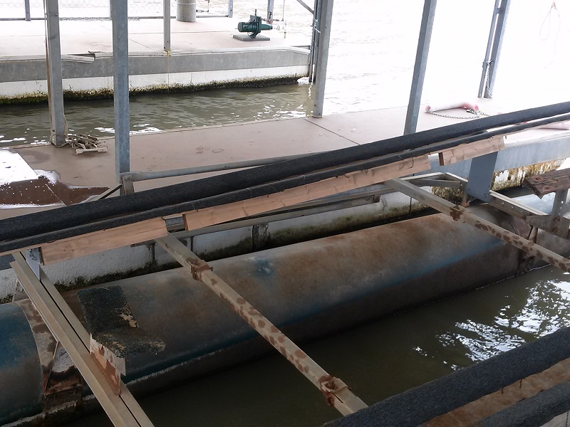

- This shows the height of the new rear bunk support -- it's 17" tall.
- new bunk placement_lr.jpg (173.96 KiB) Viewed 7412 times
- This shows the difference in height of the rear bunk supports on the lift. The left side is the new height and the right side is the old height.
- bunk placement difference_lr.jpg (158.43 KiB) Viewed 7409 times

Seems to me like you should move the lift back a bit in the slip and have the boat sit more forward on the lift. Those bunk extensions should be on the front side of the lift...not the back. Pretty sure how that is done at our marina.

I'd love to move the lift back in the slip. The problem is when the lift was installed back in the 80's, it was welded to the dock frame instead of screwed to the frame. HydroHoist quoted about $4K for new mounting brackets (shipped) and for labor. My new bracket solution was a much cheaper alternative. My other thought was to have someone modify our dock -- there's 6' of walk space in front of the slip. If we could cut into that by 2' to make the slip longer, I could pull in more to the slip thereby getting more of the weight over the bunk brackets.babock wrote:Seems to me like you should move the lift back a bit in the slip and have the boat sit more forward on the lift. Those bunk extensions should be on the front side of the lift...not the back. Pretty sure how that is done at our marina.
I contacted the Corps when I thought about adding 2' to the back of the dock (basically just extending the entire dock 2'). But we'd lose our grandfather of where our dock is located -- we are less than 150' from the boat ramp now. That wasn't an issue when the dock was put in so we were grandfathered. They said if I enlarge the dock, I'd have to move it -- that's not an option.

I was told by HydroHoist that this is an old A model. It actually raises and lowers flat - well other than it being a little unlevel due to the weight of our longer boat. I have two ropes with clips that I have adjusted to the perfect length to center the rear of the boat in the slip. I just have to pull the boat in till the nose cones touch the front of the slip and hold it there till the lift comes up enough to catch the bottom of the pontoons. Then I can let go and just let it come up - centered on the bunks every time. If we have guests on the boat, I tell them to sit still till I have the lift up enough to stabilize the boat, then I stop the pump and turn the lever to "dry dock" so everyone can get off - this puts the deck of the boat level with the dock so its easy for everyone to get off.
I think when we upgrade to a tritoon, I'm going to contact HydroHoist about either adding another tank to the lift or swapping out the 2 we have for a newer larger single tank like they use now - more like a big block tank instead of round tube tanks.
Knock on wood, we haven't had to replace the hoses or pumps on this 30+ year old lift. But I was very surprised that by just changing the nipples to the tanks that this thing works as well as it does after hanging under water for over 6 years - that's a lot of wear and tear on the brackets and lift. So I'd recommend HydroHoist to anyone thinking of getting a lift - even a used one.

They didn't give me the weight capacity (unfortunately), I may have to follow-up with them for that. But I'm sure this was only rated for 2000lbs - which I'm sure I'm slightly over by the time you add motor and fuel. The biggest reasons the boat sits lower in the rear is the back of the boat hangs back beyond the back lift support and even the hoist tanks -- with the motor and 20 gallon tank sitting at the back. This was originally installed for my dad's 18' little open bow Fabuglass boat that used 2 little 6gal tanks (and most of the time we had to take them off the boat to prevent them from getting stolen). I think I'd be fine if I could move the lift back about 2' in the slip, but unfortunately since it was welded, that isn't an easy or cheap task.

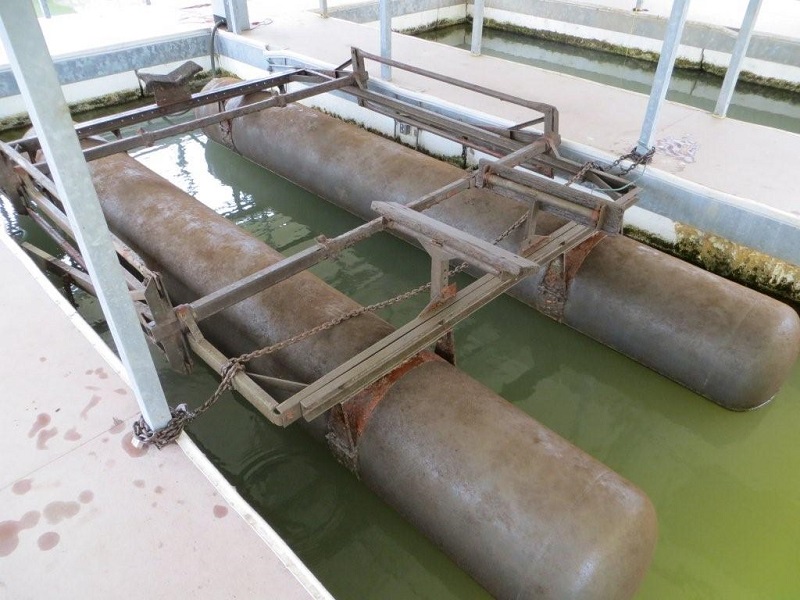

I'm not sure the bands could be loosened up without needing to replace the bands. Here's a few more pics that might show more angles. But I'm not sure only 6"-1' would be enough (as you can see by the pic below of how much the pontoons are hanging off the back of the tanks.

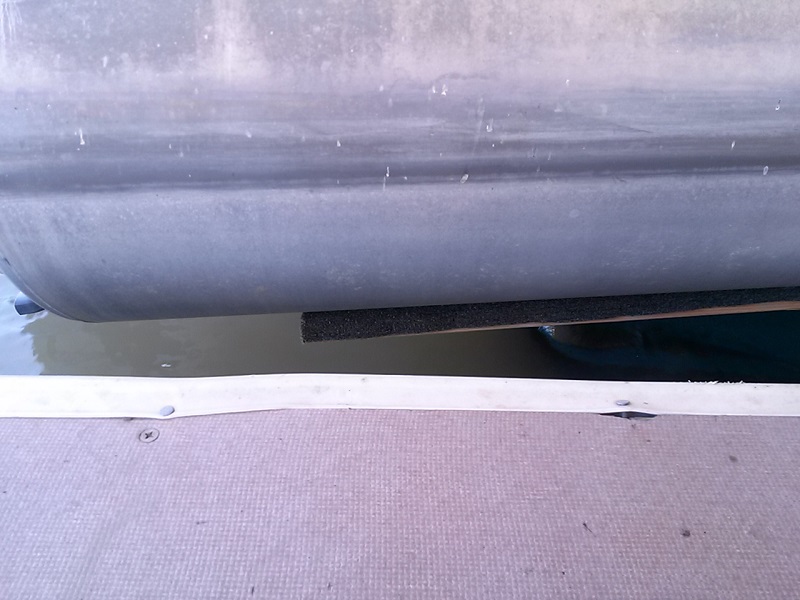

- This shows how much of the pontoon hangs off the bunk and how much farther back than the back of the tank.
- end of boat - bunk - lift tank_lr.jpg (123.15 KiB) Viewed 7113 times

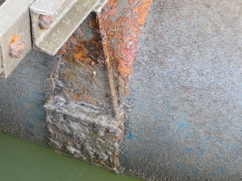

- This shows how corroded the tank band hardware is -- I'm not sure I could get them loose without breaking them off.
- tank_band_lr.jpg (222.16 KiB) Viewed 7111 times
- This shows how much of the tank is already behind the rear bunk bracket.
- lift_before2_lr.jpg (155.32 KiB) Viewed 7112 times

Judging by the pics, you certainly aren't too far back. Hell, mine is in the same general area. I think the weight rating is the key here. My J model is rated for 3000 lb. as far as hoses, again Grainger or Tractor Supply. Not sure how many more years are in those bands...
