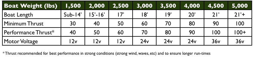

my friend is selling a 55lb thrust trolling motor, Do you guys think that is enough for an 1,800lb toon? I believe thats what tracker offers on there bass buggy 18 for an option but sounds a little small to me.

My toon is 25' 8" wet weight 3423 lbs. I did a lot of searching on forums and even called Sweetwater before purchasing a trolling motor.
I was surprise when Sweetwater expressed to me under normal conditions a 45" shaft and 55 lb trust trolling motor should be adequate.
I was hopeful my Internet searches would support this statement because of cost and battery requirements, but at last they did not.
If you can get the results you need with a smaller motor than certainly it's the way to go.
In my case I know the 55 lb 45" shaft would not have performed as needed.
I ended up with a Minn Kota Terrova 80/US2 80-lb Thrust Freshwater Bow Mount Trolling Motor with i-Pilot, 60" Shaft.
This unit does a nice job even in 15 mph winds, however the best I can hope for is around 4.7 hours of continuous running at 2.4 mph and less time in 15 mph winds, using two group 27batteries.
I love my i-Pilot, 60" Shaft system and again know the 55 lb with a 45" shaft would never had perform well for my toon.
Definitely go with at least a 52" shaft or greater, and if you have easy battery charging capability consider a 24 volt system you can't go wrong.
With 24V your size toon you should get 7 hrs or more run time and likely be able to exceed 3.4 mph.
Minn Kota also has a shaft length chart on their site.
Don't know if weight is based on dry or wet.
Good Luck with your purchase.

Thank you, great info there, I love that i-pilot. I may have to do an "end round' on my wife for this one. when she saw my list of want's and needs with prices she almost fainted. I really do think I need a 70lbthrust and would like a seperate battery for electric anyway. I didn't consider shaft length, my friends is to short. I think wet weight will be under 2,500lbs.. I know i'll regret it if I don't buy i-pilot. thanks again.
