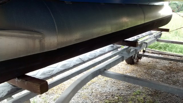

I use 4x4,s on top of the bunks when painting ours. I was told at the dealership not to put the blocks at the weld sites, but near them.

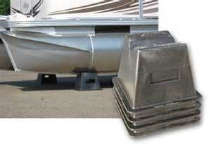

Here are the toon pads in case somebody has not seen them yet.
my dealer sells them and recommends them,
The manufacturer of my boat recommends that they be placed on each weld seam or 3 per side on my boat.
They sell in sets of four but will sell you six if you ask nicely.
I am getting too old to hump concrete blocks or old dirty tires around.
I have seen pontoons around here on 4x4s, concrete blocks, bricks, tire rims exc. I am sure many are damaged.
I am sure that the ideal thing would be to place about 6 tires on each side, that would really cushion the toons best.
I do make sure that they are on a flat level area so the toons touch evenly and nothing is twisted.
These things are the best thing since beer
Mike

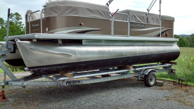

grouser wrote:I would question the logic behind not putting the support right on the welded portion of the toon. It has to be the strong point IMHO. BTW what did you use to get the bote up off the trailer?cleatus wrote:I use 4x4,s on top of the bunks when painting ours. I was told at the dealership not to put the blocks at the weld sites, but near them.
I thought putting support at the welds would be the proper method also, I don't know why they (dealership) told me different, maybe someone on here could let us know what is right, though Mike's owners manual did say "at the welds", so maybe that is the way to go.
I used a T-brace (deadman) with a floorjack to pick it up, the full length keel is sitting on the 4x4's, above each bunk support. It is only temporary, maybe 2-3 hrs, to apply the bottom paint . I've done this twice so far with no damage to the tubes. It sits on the trailer all winter like BobG.'s.
RcgTexas- It's a copper free anti-fouling paint (Pacifica Plus) on top of an epoxy barrier coat. It's pricey but works great, our boat is in a wet slip all season and I paint her every other year.
BTW, they are 27" tubes on our boat, I'm happy with the ride.
