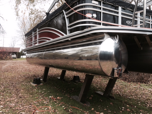

I would recommend having it done before it gets tarnished, I should have done mine last summer when it was new. When I took it out in the Fall I had to polish the tubes to get them uniform a lot of work I don't want to do that again. I then wiped on 2 coats of shark hide, here is a picture after I got done with it.
- FullSizeRender(1).jpg (157.86 KiB) Viewed 10344 times
