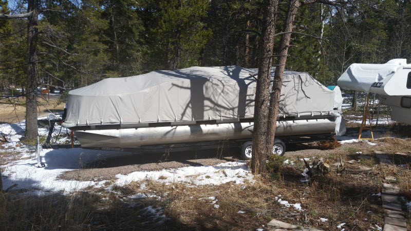

#7 Post by BobG » Fri Apr 03, 2015 1:18 pm
If you want it to be towable, you better be sure to secure it very well! Snaps probably won't cut it.
As you can see, mine attaches very well to the deck.
Oh, yeah - that is today's snow. We got about 4 inches last night.

BobG wrote:If you want it to be towable, you better be sure to secure it very well! Snaps probably won't cut it.
That looks like a great cover. It appears that your bimini is under the cover also. Do you have more than one bimini? What are the white attachments on your deck line?

Re: Boat Cover getting Underway
#12 Post by BobG » Tue Apr 07, 2015 7:46 am
WoodenPontoon wrote:That looks like a great cover. It appears that your bimini is under the cover also. Do you have more than one bimini? What are the white attachments on your deck line?
I expect to use "hard action" snaps in conjunction with hidden straps to the frame.
Two Biminis are still attached to the top rail, and the third bimini is laid down on the cabin floor.
Those are 1" heavy nylon straps, metal loops on the deck, and metal buckles - they're what you would use on packsaddles, I'm guessing. I'll try to get a close-up, but today I'm working down in Denver, not at home.
The fabric is reinforced anywhere something might poke it.
My canvas guy (he's amazing) is Paul's Custom Canvas in Denver. That cover cost me about $1,250, if I recall correctly, and was worth every cent!

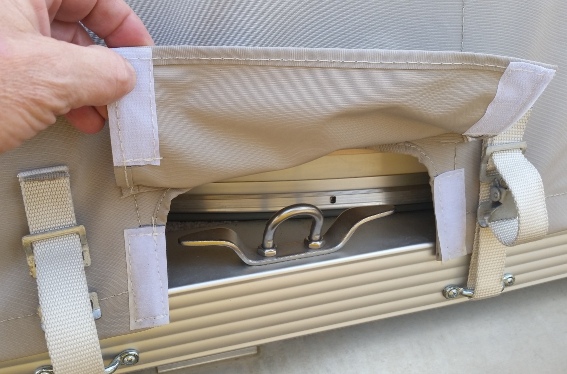

#14 Post by BobG » Fri Apr 10, 2015 9:12 am
Here are the pics.
Flap covering cleats, so it can be used as a mooring cover, and still tied up:

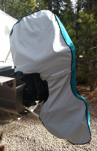

#15 Post by BobG » Fri Apr 10, 2015 9:14 am
Oh, and this is our motor cover from Outboard Covers Australia:
