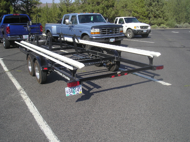

Re: what bunk slides do you guys recommend
bunk caps from Eastern Marine on hand applied water seal Douglas fur boards
- we don't need no stink'n carpet2.JPG (287.46 KiB) Viewed 7992 times
KylefromNJ
- Posts: 55
- Joined: Thu Apr 10, 2014 7:17 am
Bingo! that's exactly it. thank you sir!
