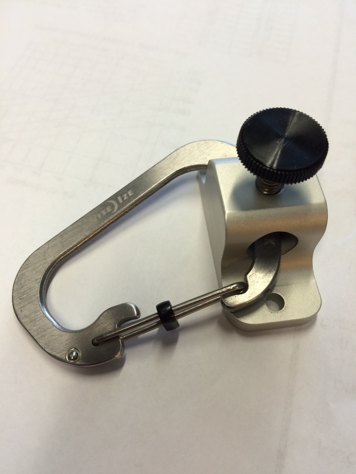

Here's what I found for a carabiner. Seems to fit good.

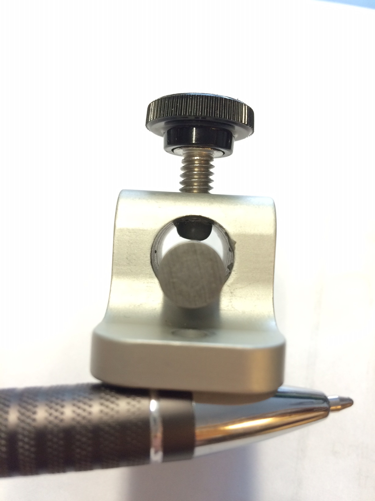

The other picture shows a .350" gage pin in the EZfender, just barely fits under the screw. A 3/8" pin will not fit through, since the screw cannot be turned further out because of the JB Weld. Not even close to 7/16" clearance. So if a steel pin doesn't fit, how can I expect to conveniently push a rope through there?

You can open up the thumbscrew without ruining the threads. My anodizer did a small batch for me trying to eliminate pinching the screw. I found pinching the last thread of the screw works better, because of the clearance. If you want to send those back I can shoot you off some with the pinched thumbscrew. Other wise, just twist the thumbscrews out more, or if you want to remove it, I can send you new thumbscrews. Sometimes a person does you a favor with good intentions that don't play out the best.

I bought the carabiners at Menards, something like $3.99 each. The shape fits easily through the EZfender hole, and they're flat, about 1/8" thick. Ran the different ideas past The Boss, and she likes the carabiners better than feeding rope through, so I'll tie the lines to them and try that.
Using the carabiners, I think it's probably better that the screws have the JB Weld on the ends. It will provide some protection to the carabiner. If we decide to run rope through instead, I can file it off a little with a rat tail file.

The ones I got the last couple of weeks are the same way-too much JB weld preventing them from opening up enough. I found you can keep turning them and the JB weld will come off without damaging the threads.

Yep, I took what was remaining and changed them to the crimped. It was a good thought of him to do it for me. But in the end, not a good decision to go with. Glad he didn't do my whole batch! My fingers would be worn down to nubs!
