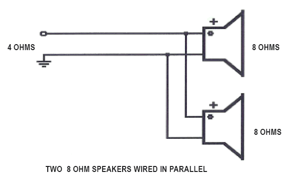

Just so I understand the wiring for the 2 pairs of 8-ohm speakers do I run 4 wires from the 1 channel of the amp 2 wires to each 8-ohm speaker or do I run two wires to 1-speaker and then from that speaker connection do I run two wires to the 2nd speaker?
Thanks

#6 Post by ToonGuy » Mon May 18, 2015 5:34 am
Wire both rears like this:

#7 Post by garygve » Mon May 18, 2015 7:49 pm
Thanks for the diagram.
