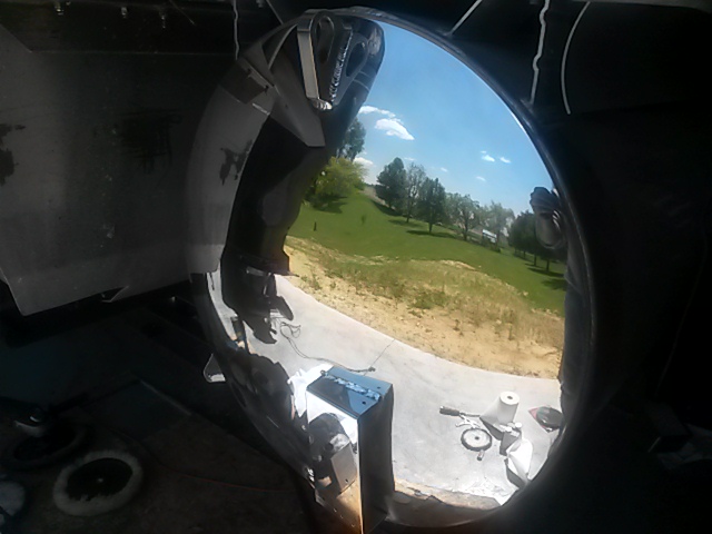

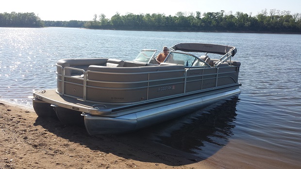

I finally got the end caps polished and Sharkhide applied. Been trying to get them done for 4 years now. As soon as the Sharkhide cured, out we went. First cruise of the year. 67 degrees out, but sitting in the sun felt like it was 80. Boat ran great, even with 52 gallons of last years gas in it. Don't think the flywheel spun a whole revolution and she was running. After a 108 hour stretch at work, I was ready to go. And Denise was too! All that is left to polish is the transom, when the motor comes off for the jackplate, we'll get it done. Now, back to work for a quick 48 hours in 4 days and off for a couple more. Hope to get wet again next Tuesday.

While I was polishing it, I saw the reflection of a deer running through the back yard. That was perty cool. I figured it was getting close to done, after that.
I got them both done in under an hour. From removing the coating that Premier put on them to Sharkhiding. I'm finally getting it down to a science. After doing 8 boats, I should be figuring out the shortcuts...

Bryan: What polish did you use to get that mirror finish? And what kind of polisher are you using?

I use rouge bars. Tripoli for the rough cut and white rouge for the final. I use 3 different wheels, spiral and loose section buffing wheels and a lambs wool buffing pad. The secret is to use a D/A first. I use 320 for the first cut IF IT HAS NOT BEEN polished and is has small abrasions in the surface and then go to 600. Or if its smooth, I'll hit it with 600 to open up the aluminum. 600 won't leave any sand scratches. I use 3 polishers. A DeWalt, a Wen and a cheapo Drill Master from Harbor Freight. I use the cheapo the most. $40 bucks. Why? The Dewalt is too uncontrollable. I don't even use it. I paid close to $200 for it 3 years ago. The Drill Master winds up slow and has 6 speed ranges. Also has spare brushes with it. The Wen is my rough cut polisher. I've had it for over 20 years! Use a ton of lacquer thinner to keep the black build up off between buffs. I buy my pads at Harbor Freight. 3 different wheels for 10 bucks. They work good if you use some 4" grinder discs on the sides when you put the wheels on. Wish I could show you how I do it. I need to buy a Go-Pro some day. But the movie Sex Tape kinda scared me away from it.
The best canned polish I found is actually Mothers Mag and Aluminum polish. I tried Flitz. No way... Burns too fast. Mequires Heavy and Medium cut is too runny, flies off the pad. The Sharkhide polish is good! But the bars work best, for me!

Bryan: I figured you went to the rouges and a high speed buffer.
I've got the high speed buffer, but not the desire to manhandle that monster. I'll be using the D/A and the White Diamond metal polish tomorrow if the weather holds out.

Let me know how the White Diamond works. I've been having the best luck with the bars. The canned compounds work good, but the bars seem to last a lot longer after you load up the pad. I was kind of thinking of making my own mix, breaking up some brown and white bars into some old plastic containers and diluting them with some mineral spirits and carnuba wax. I could make them thick enough to paste onto the pad. I have to go buy some pool filter sand this morning, I'm gonna stop off and buy some new bars and do it. I'll let you know how it works.
