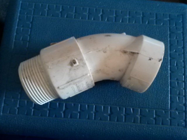

My Manitou did the same thing. I also put in a vent going into the side wall. I fond the fume sensors kept shutting down the pumps. I made a funnel out of PVC that I could screw in the fuel fill. Had to remove the caps security chain. But it worked great! You could put it in as fast as a car. The thread size on the fuel fill was 1 1/4 and a PVC adapter screwed right in. I have a pic yet somewhere, I'll try to find it. I think the funnel is out in the shed. I'll look for it. The Manitou and Premiers bulbs never do got hard, either. Not like my old Merc and Evinrudes, did. I think its got something to do with the fuel injection, or maybe its in the venting system.

Ah Crap! I forgot to take that picture!---------------------------> heading to the shed, right now!!!
....... Here it is, this took care of my fueling problem with the Manitou.
It was 1 1/2" Diameter, not 1 1/4" like I think I stated above...

Anyway, it took gas as fast as I could give it afterwards, the only down fall was I had to take off the lanyard. I only the lost the cap once at LotO, looked like a giant Moltov cocktail with that red rag stuck in the fuel fill on the way home!
