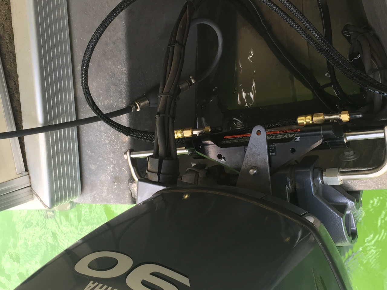

My steering has been getting stiffer and it was getting to be a PITA.......
So I bit the bullet and got the Baystar kit off Ebay......... http://www.ebay.com/itm/161219792846?
Started Sat. morning at about 10:00AM .......by 1:00 PM we were headed to the lake....
Damn!............night and day difference.
This kit fit my rig like glove........Really high precision assembly.....very easy to install (after fighting to get the old cable steering off...cut-off wheel was VERY effective!)
Sorry............I only got one pic...view from the top......the lines with the braided covers go to the steering cylinder.
Made a big loop for clearance as they move side to side.....a little pricey.......but very happy....... wish I had done it when I got the toon..!
With my "roving" tennis elbow (moves from right arm to left arm occasionally) it's much better.
Not "one-finger" like a power assist with a pump, but effortless and the motor will not move from torque if you let go of the wheel....My Benny steering wheel bolted right on too.
