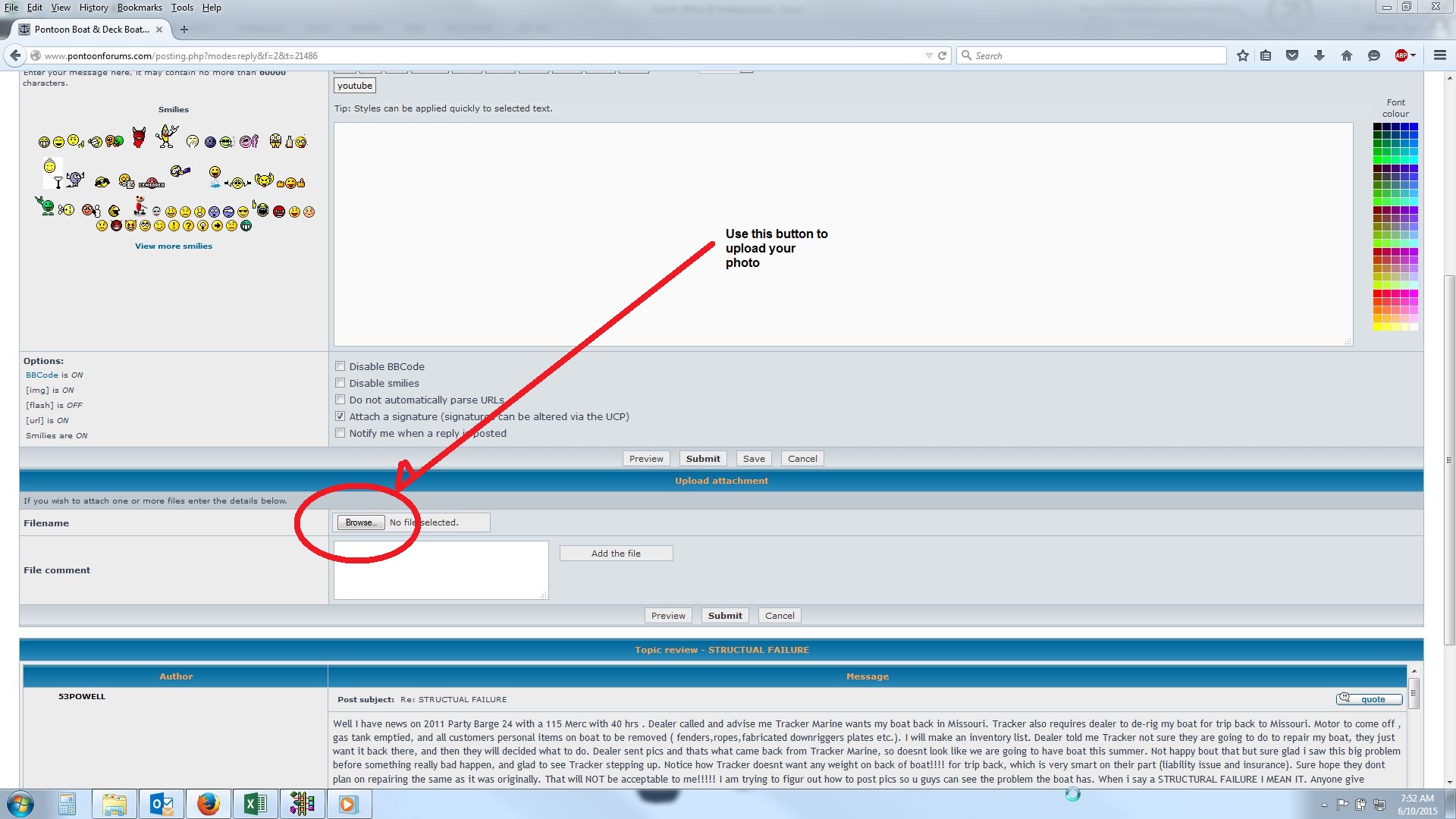

Re: STRUCTUAL FAILURE
When replying or writing a post, under the section where you type you message, there is a section labelled "Upload Attachement". Click on the "Browse..." button to the right of the word Filename. Then select the picture you want. When it selected, you will see the file name next to the browse button. then click "Submit"
Easy peasey!
Tim
Easy peasey!
Tim
- screenshott.jpg (360.45 KiB) Viewed 10854 times
