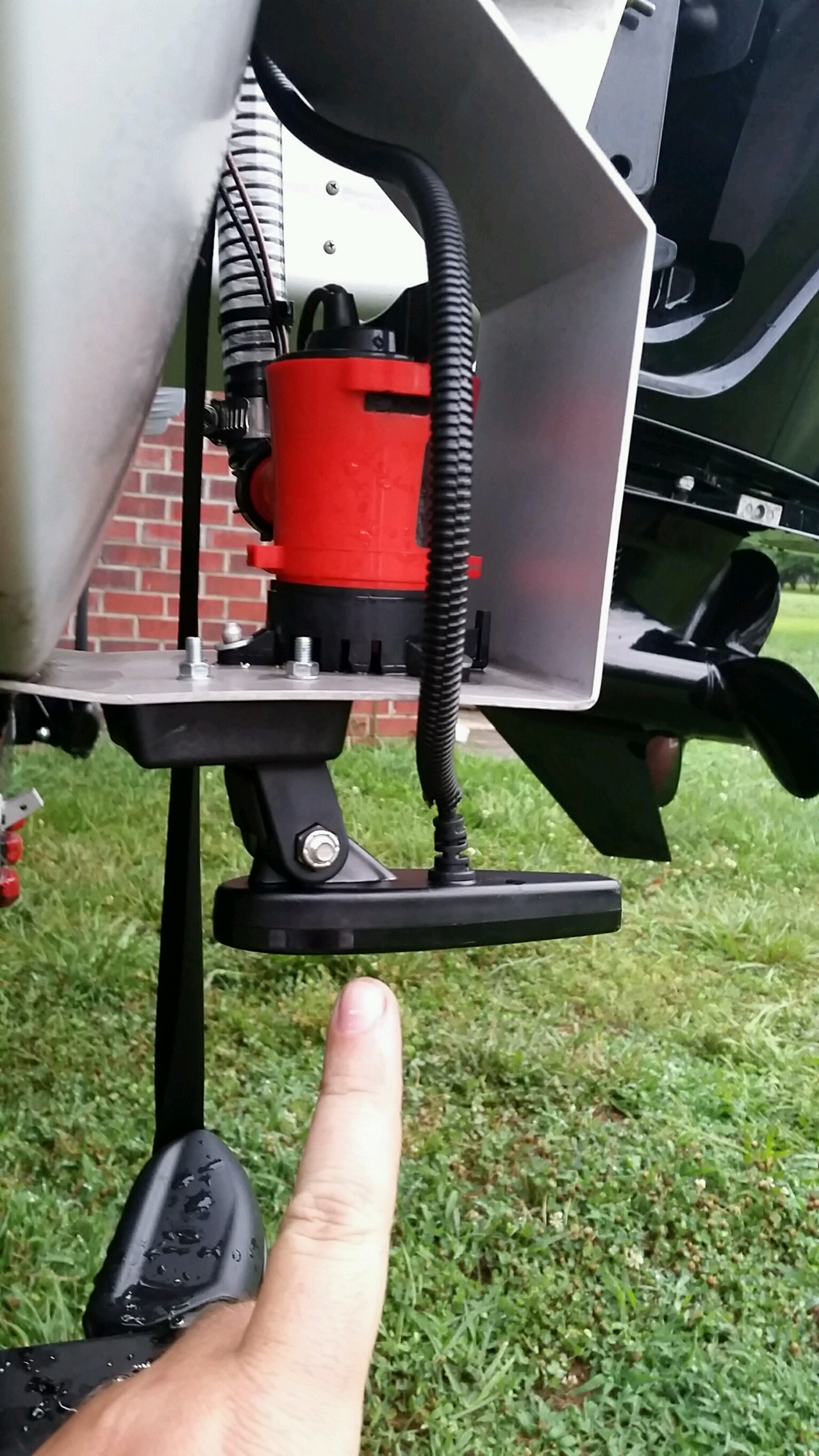

I mounted mine at the bottom of the bilge pump on the back of the pontoon.
That's a good idea!
Any problem with it at higher speeds?

not sure yet.. Just mounted it this week, haven't put it in the water yet. stay tuned to the same bat channel for further updates..

We have ours mounted similarly at the bottom of the pontoons. The only issue arises when you end up in very shallow water and you risk damage to it.

Mine is mounted similarly. I found it sometimes has issues above 8.5 or 9 mph. Goes to zero depth.
I suspect it's from turbulence and/or air coming under the toon.

Yep! that's my problem as well. it will go to 1 foot at 16 mph. I also thinkits because of "bad" water coming from under the log.
I wonder if I put it on the center log right in front of the motor mount and just stuck it to the 1/8 aluminum plate that is the bottom of the center log ? That would take a special transducer though wouldn't it?
