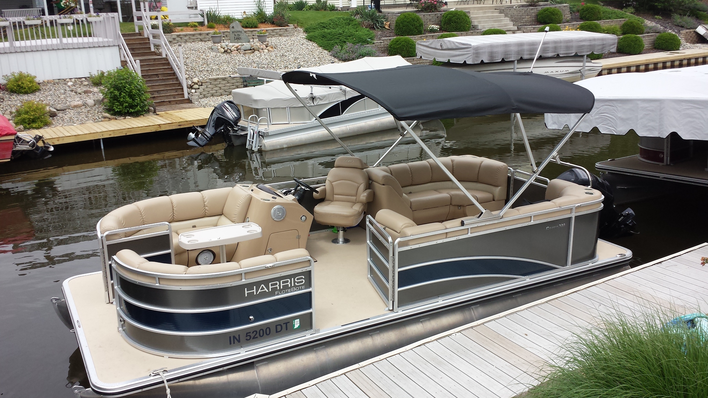

i just installed a power arm on my 2014 harris cruiser 200
The power arm sits a little lower than the standard oem binimi
you may be able to lower the rear by cutting the stow legs a little, i was going to play with it this weekend but too busy. i have a low bridge to go under and with the rain we have had, it is getting a little tight, had to remove my windshield and the binimi clears by about 3".
The top is very stable on my boat at 27 mph or so I think you would be good at 35 depending on the wind, the factory claims that they have tested up to 60 mph or so.
My neighbor has a new harris with factory installed power arm and harris included the front binimi arms and told him to use them when underway at high speeds or if parked and it is windy.
i forgot to get photos this weekend i will try to remember and will get you a measurement of the stowed height.
I really like the power arm, works well and very heavy duty. i will have one on my next boat.
one additional item, my dealer told me that if you hit the top on a bridge, you will damage your side panels because the top is so heavy duty it will transfer the force to the side panels, on a standard oem binimi the top will bend first.

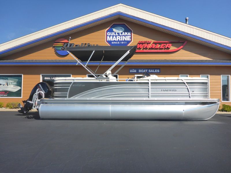

Cool, I'd be interested in seeing pics of your install and info on where you bought it.

Re: Powered Bimini Top
Mike, You mentioned your neighbor has a Harris with the factory installed power top, on the Harris website they show it as a 12' power bimini top. Can you find out if his factory one is 12', the Power Arm one is 10'.
Thanks

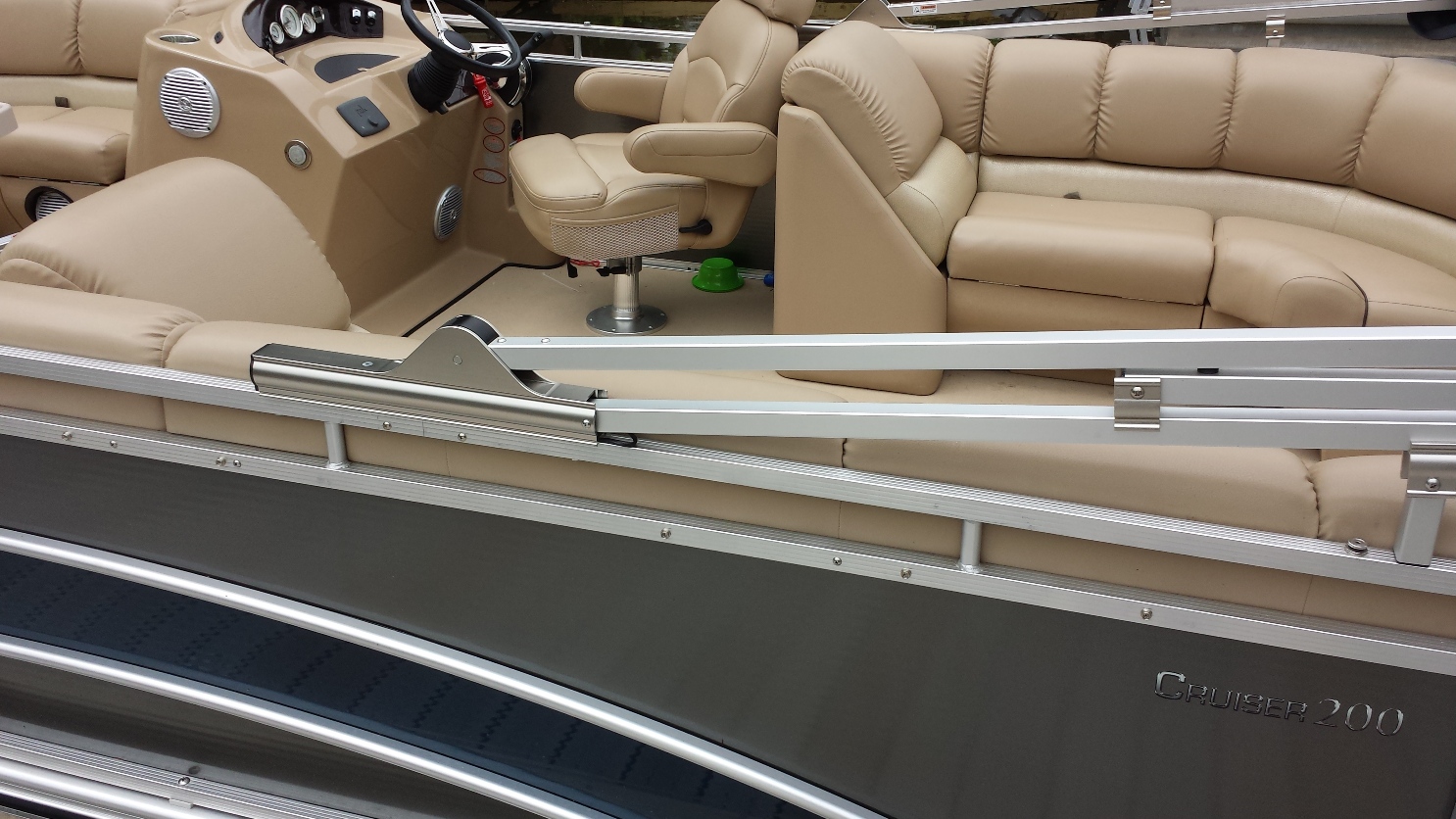

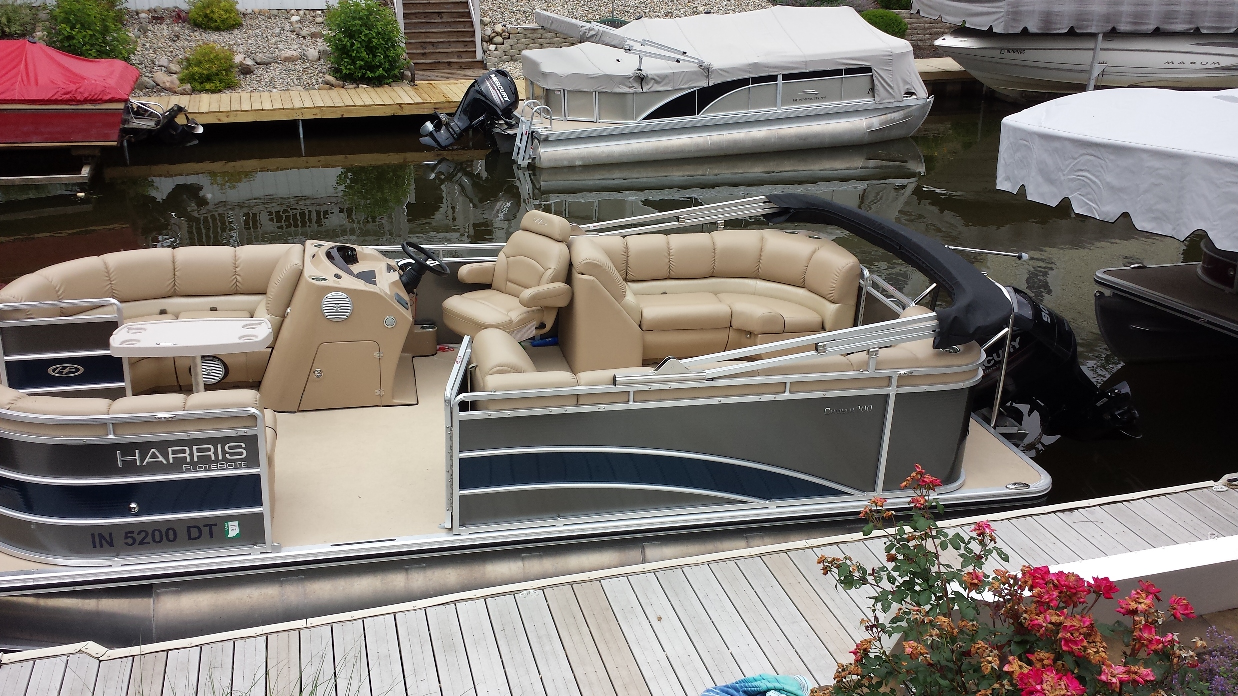

Here are the photos of the power arm
The top is 14" off the rear rail when lowered
I am planning on cutting about 2" off the arms that should lower to about 10" or so

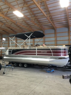

I also attached a photo of my lift setup ( i know how you all like photos) I took the canopy off my old deck boat lift and
installed with augers and placed a center lift pontoon lift under it.

i finally got around to cutting up the back legs
i cut off 1.75 inches and it lowered the top from 14" to 11"
another note is that you will have to modify your cover to clear the actuators
Mike

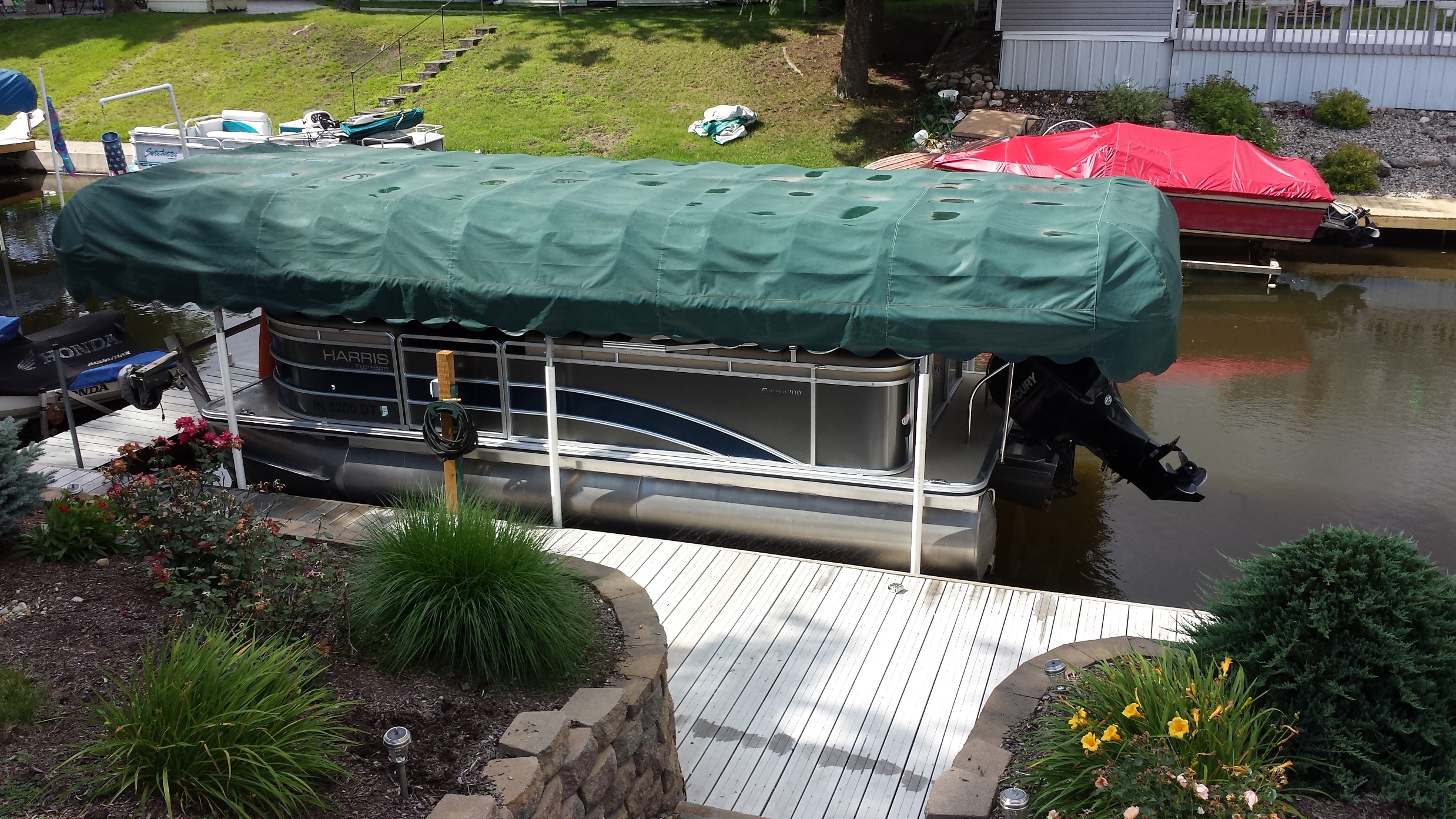

From the pictures I'm seeing on line of the Harris factory installed power tops, I think the guy from Harris that said they are 12' long is wrong.
I'm going to order the Power Arm and install it as it comes based on ToonGuy and Crookedlaker comments about the frames being stronger.
Here is my pontoon with the 12' top and a factory installed power top I can see that the factory installed is is 10' long not 12'.
