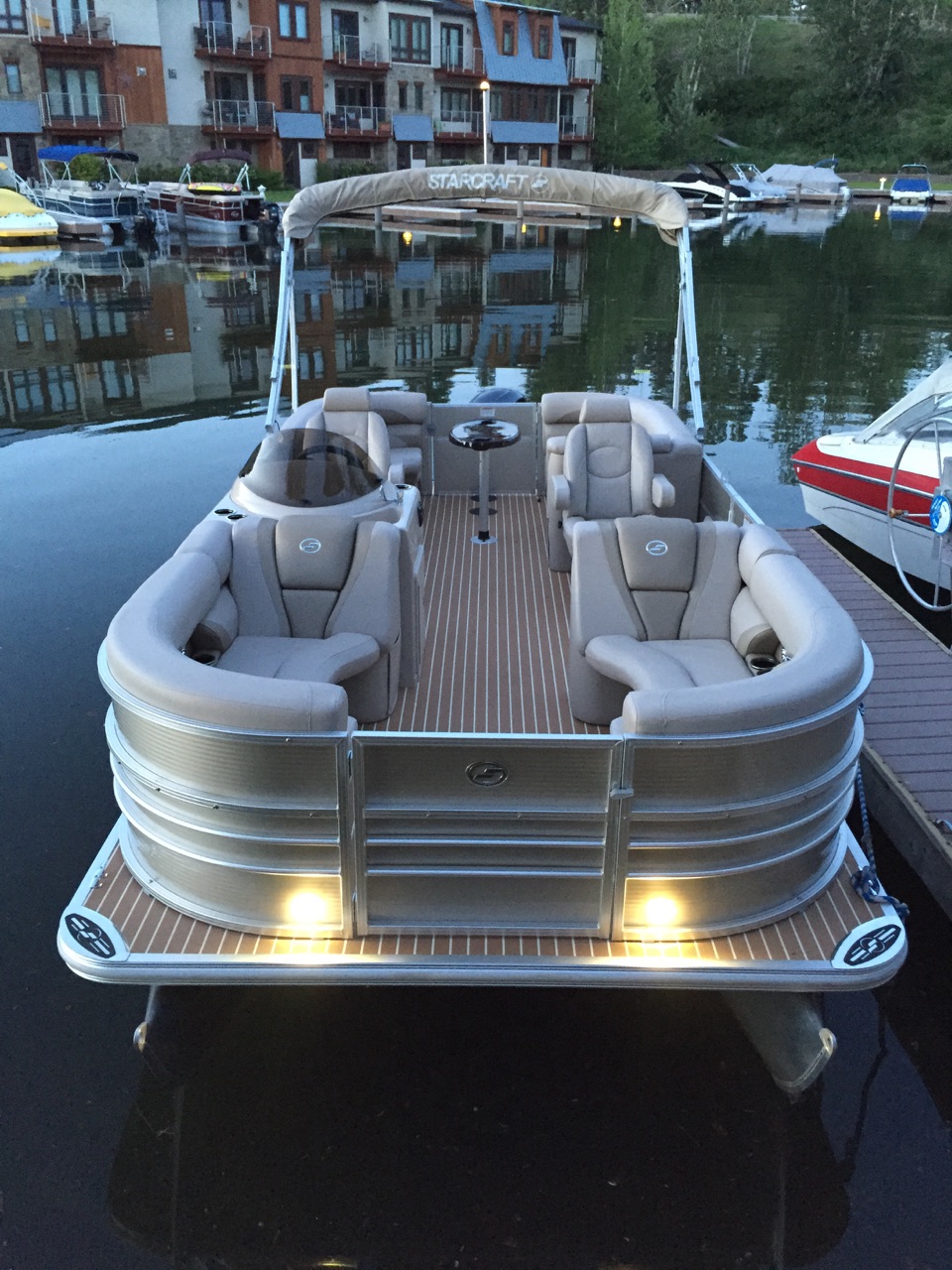

While I'm not new to the boating world, I am still pretty new to the Pontoon Boat world. My wife and I bought a Starcraft Stardeck 216 Starlounger, and there are a lot of things I really like about the boat. I like the look, the floor plan, the color, basically everything about the boat when we're floating out in the middle of the lake goofing off. However, once we get a few people on it, the boat is simply a dog. The Yamaha 115hp Motor is quiet, pretty fuel efficient, but if there are four adults on the boat you're not going to see a whole lot more than 22mph. By myself I can squeeze 30mph out of it, but the lake has to be perfect for that.
I know the boat say's that 125hp is the max for it's setup, so legally I can't go past that, nor do I want to push the boat past what it's meant to do. My wife is also in love with the boat, so talking her into something else is going to be an up hill battle that I don't even want to face. I'm open for any suggestions anybody might have. Is there different props out there that can help, is it financially and feasible to add a tri-toon and a bigger motor? Again, I'm open to anything.
- IMG_0621.jpg (363.35 KiB) Viewed 5811 times

Strake- at WOT the boat will run 30mph at 6,200 RPM's. I honestly didn't think much about the top being up having that much effect on the speed, but I guess it is basically a big ass sail, so that makes sense. I appreciate the thoughts. Like I said, most the time the boat is great, but I just wish I had looked a little harder at the motor size.

There is something missing in that picture..................a center log with strakes!
