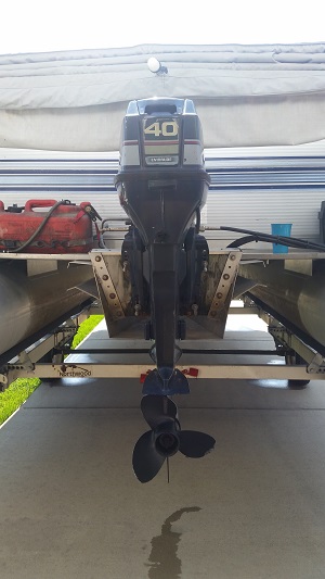

My pontoon is a 21ft 1996 Northwoods with a 40hp evinrude
Saturday when I had it out for the 3rd time I noticed the rear was sitting very low. To the point water was going over the back of the toons while sitting and moving. When WOT I have a fountain of water shooting straight up left and right of the transom.
There was not much weight in the boat at all. 2 adults 3 very small children (under 4yrs).
On the rear:
40hp evinrude
6 gallon fuel tank full.
1 battery
I also noticed a lot of drag at to mid and at WOT.
Once I got home I really took a hard look at the back of the boat. First, I made sure there was no water in the toons. Took the plugs out along with the air pressure and lifted the front of the trailer all the way up. Notta.

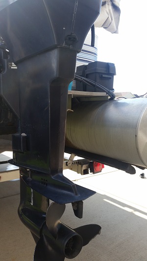

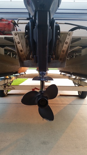

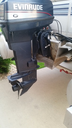

Second, I raised the motor up to the max position. This reduced the drag a lot, But water still like a fountain in the back.
My questions are by the looks of the pictures is my motor still too low? Before it was down all the way now I moved it all the way up, but can't go up anymore with drilling new holes and will need to in order to make the cav plate level with the bottom of the transom.
Second, How can I go about adding more buoyancy to the rear of the boat? I noticed my transom is wide open at the bottom allowing it to fill up with water. Should I close this off? Add a bilge in there? Thoughts, opinions?
