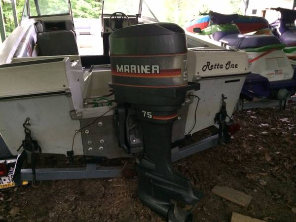

There is a (open-bow runabout) boat locally with a 1985 75hp mariner on it. The tilt/trim is not working on the motor, that is supposedly the only thing that is wrong with it. Which, I think we could fix ourselves (hubby is pretty handy, but isn't the greatest at the internets, lol, hence my posting).
I have attached a picture of the potential boat with the motor....
our plan is possibly get the boat, switch the motors, then resell the boat.

If I was re-engining a boat, it'd be with a really good, trouble free outboard motor--preferably a 4 stroke motor. I wouldn't want to put a 30 year old motor on any boat as chances are that troubles are in your future.
The condition of the Playbouy pontoon is of the utmost importance, and they're high quality hulls. (They're the predecessor of the current Tahoe brand boat.) If it's really sound and has great seating, etc., go for a modern generation outboard engine.
Brand new 50 hp to 75 hp motors run from $5K to $7K not including controls. 75 hp motors are a lot stronger than a 60 hp motor--more cubic inches. See JacosMarine.com--a big internet seller.

You should be able to find a used, newer 2-stroke or 4-stroke for a good deal with lower hours. Sometimes though it's cheaper to just switch boats.
