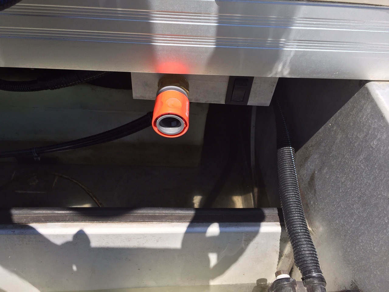

I have the exact same pump. Attached is a simple panel I made with a 3/4 hose barb to 3/4" GHT brass coupler along with a Gardena quick disconnect. The rocker switch is a submersible (sealed) rocker switch that is fully potted which I got from McMaster Carr. I mounted the pump upside down to the underside of deck behind the panel. It pulls suction from the motor pod through 3/4" heater hose with a 3/4" hose barb to 3/4" NPT to a standard livewell basket strainer.
Be aware these pumps draw a lot of current. The specs that came with mine called for more than the seller's website listed.

Yep, I installed mine on a separate battery. Kids like to use the washdown pump and didn't want to kill my starter battery.RobZ71LM7 wrote:
