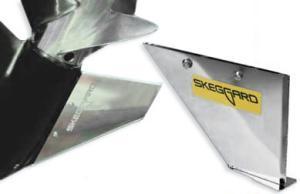

I've used Skeggard on my own and work outboards over the years. They just bolt over the existing skeg. I'm considering getting one for my toon, just as insurance.
http://skeggard.com/

I have a skeg guard on mine. Works out great.BoatCop wrote:I've used Skeggard on my own and work outboards over the years.

I have also used something quite similar to SkegGuard and they are indeed good. Easy fix for the broken skeg or nice protection for a good one.BobG wrote:I have a skeg guard on mine. Works out great.BoatCop wrote:I've used Skeggard on my own and work outboards over the years.
The only reason I mentioned welding on a skeg with the lower upside down in a water bath was to highlight how a proper repair is made. For those that like their boats 'factory'. Prolly helps make a sale as well. Every time I see a skeg guard, I wonder what's under it...then I wonder what got hit to prompt putting it on.....then I wonder if the shaft is bent....then.....ad nauseum

Shoot, I just thought it was nice bling to go with my stainless prop - and to protect that fragile aluminum appendage. Mine hasn't been damaged, and I want it to stay that way!tuned wrote:Every time I see a skeg guard, I wonder what's under it...then I wonder what got hit to prompt putting it on.....then I wonder if the shaft is bent....then.....ad nauseum
