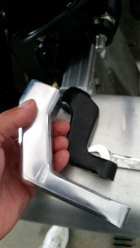

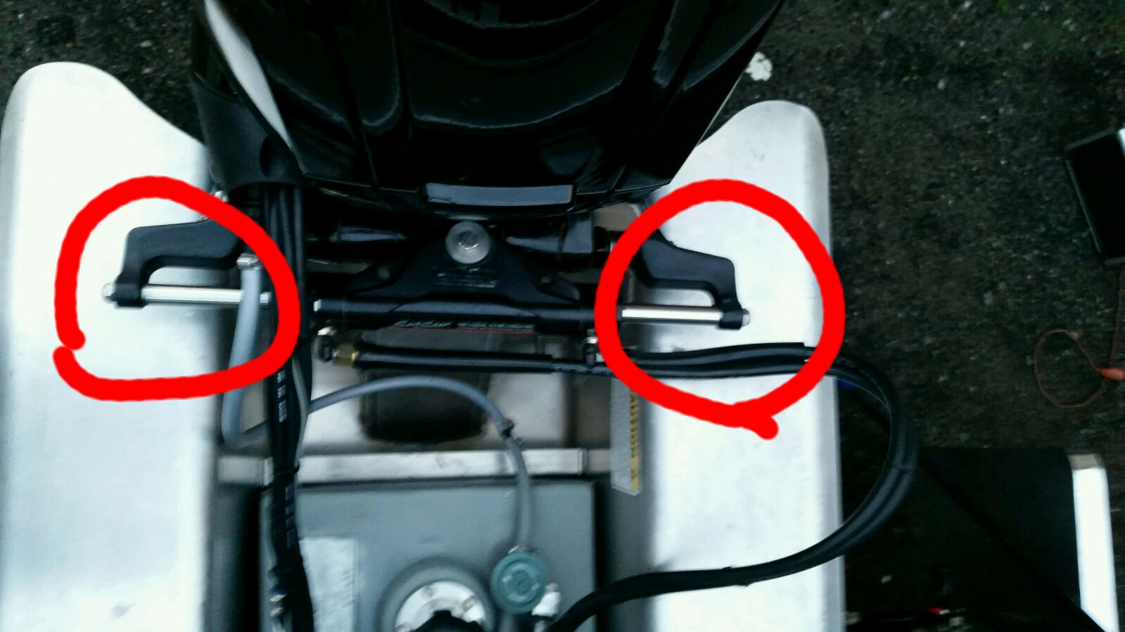

Here is the arms on the steering, it has a trim stop so it won't impact the transom pod. The prop is a 5x15 I think. It's a 15pitch and larger than the normal bigfoot prop.

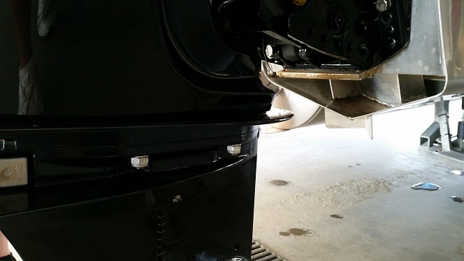

I had this problem with my new 22DLK Fishn Barge. First problem was the wrong prop. Corrected that but still had an issue and found removing the little 'V' on the bottom of the motor pod totally fixed it.
Here is a similar thread. A few post down the first page shows the V on my setup.

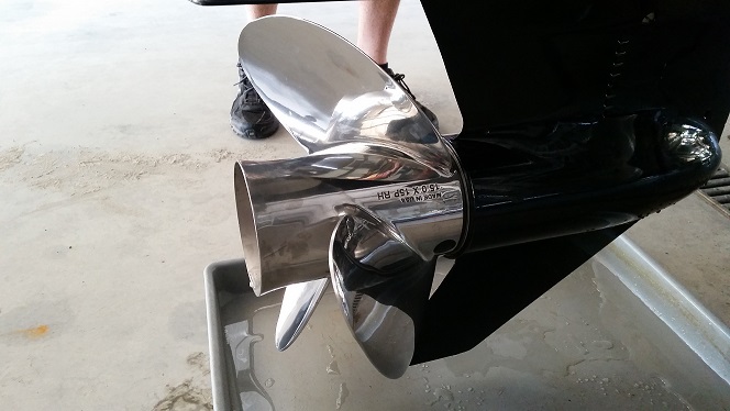

Here is the new prop 15.0x15p enertia

here is the "V" at the bottom of the transom.....which, I should not need to cut off! 40k and cutting things?! WTF where is the R&D!!!

The new milled arms for the steering worked great but the steering plate did not line up properly, ill need to fab another one.

$800 for a stainless prop? You can get an Enertia prop for $479 online.
