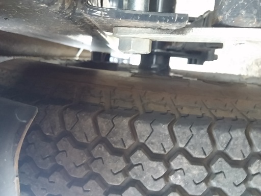

I got the cap back on and it is nice and snug. I did notice the suspension is compressed pretty good. More so on the port side with about an inch of space between the tire and fender. I noticed rub Mark's on the tire on that side. This boat should be well within the axle weight ratings and the tire ratings. I'm suspecting the leaf springs need to be changed now. The other possibility is that I have water in my left toon causeing it to weigh heavy. I'm taking it to a scale this evening to see if it is heavier than it should be. I have a feeling that I'm not done with this yet. I'll be lucky if I get to use this thing the rest of the year at this rate...

One of the problems with cheap chinese axles is that they are frequently totally out of alignment.
That could easily account for the rub marks your talking about.
If springs are rubbing on a tire, the tire won't last long.

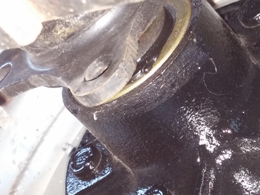

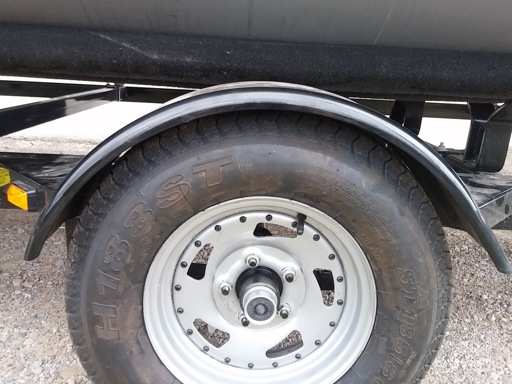

Towed the boat down to the dealer to take a look. Brand new hub assembly is already bubbling grease out of the inside. Less than 40 miles towed. You can see how bad the suspension is squished and rub marks on the tires from the fenders. We took a look at a 16 ft fully equipped boat and it had the same trailer is my 20ft. I think we are starting to see this story come together a little bit...
The good news is that they are still working with me. I have been very patient and chordal with them which helps I think. I might get to use this thing before winter...
- Hard to get a good picture, but you can see the grease bubbling out of the inside seal. Brand new....

- Dark line on tire sidewall shows where it has been rubbing on fender.
- 20150822_093611.jpg (54.52 KiB) Viewed 6302 times
- Room between tire and fender...less than an inch.
- 20150822_093601.jpg (73.61 KiB) Viewed 6304 times
