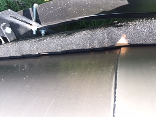

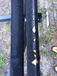

Is it typical for carpet to rip easily on trailers or am I loading my pontoon wrong?
See pictures...
I've owned by pontoon since spring of 2015, brand new pontoon, brand new trailer.
I load like this: https://www.youtube.com/watch?v=VtAxrQGww9k
But I do put the trailer a little farther into the water. Basically til my suburban tires meet the water. My pontoon is 23'.
After one season of use my trailer carpet is ripping (see pictures) and the company says I'm loading it wrong.
(sorry the one picture is upside down. Not sure how to flip it)
See pictures...
- trailer with pontoon on it
- IMG_1282.JPG (34.23 KiB) Viewed 3961 times
- trailer without pontoon on it
- IMG_0957.JPG (47.41 KiB) Viewed 3963 times
2015 Sunchaser Fish-n-Cruise 23' with a 115 hp Mercury Command Thrust motor

looks like felt to me instead of carpet. That's pretty weak carpet. It should not wear in one season! Warranty issue?

That is power loading, it is not the correct way. if its on cement its fine I guess. your carpet should not be ripped. mine is a 2015 I've loaded and unloaded 30 times this year still looks brand new. what brand is it? It does look like felt.

your carpet shouldnt be tearing after 1 season... I bought my boat and trailer in 2010 and the carpet still looks good.. now we do back the trailer down and get the bunks good and wet before loading.. and also, about 3 or 4 times a season I spray the bunks with a product called liquid rollers... supposedly causes less friction / drag when loading and unloading... a word of caution though before using anything like that on your bunks... if you use it make sure you keep your boat winch hooked until you are ready to put her in the lake.... I have a friend who used a "similar" product on their bunks and when they were backing down the launch, the boat slid right off the trailer onto the launch.... wasn't a pontoon boat but the same principle applies...

I think this is a matter off loading. Seems your bunks are 80% out of the water and all the weight is sliding on a dry surface. If you have the small keel on the bottom of your toons not right away centered on the bunks that will rip felt or carpet.
Should be an easy fix or use the plastic bunk covers.
