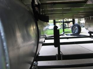

thanks for the quick response i am veryh impressed with this site. okay i have some pictures ill post. but first ill clarify the pontoon bounces not the trailer. the trailer is an o9 karavan single axle. Thanks heatman that is what i was thinking but wasn't sure if were to hook the tie downs to. here are some pics of our new toy thanks again glad to be apart of this forum

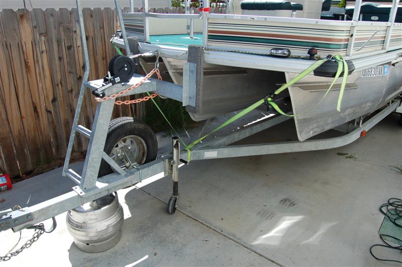

I have a long ratchet strap from one corner tie down point, down under my trailer and up to the other corner tie down point... Works great, no bounce!
I will see if I can dig up some pics...

Re: tie downs up front
Here are some pics of my setup... Looks like I am gonna need to get a new front strap soon!

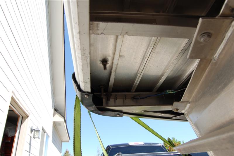

Here is the underside where the eyes I hook my tie downs are attached to, nice and solid!

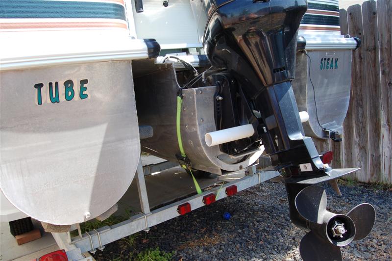

Here is the back tie down strap

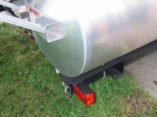

okay sorry later than i wanted but the yard work comes first
- also want to know if i should adjust the guides
- IMG_2632.JPG (21.25 KiB) Viewed 10970 times
- not much room but they are on the edge of the bunk
- IMG_2634.JPG (22.86 KiB) Viewed 10966 times
No I wouldn't go any more then a couple inches if that. I guess the ratchet straps will have to do.
