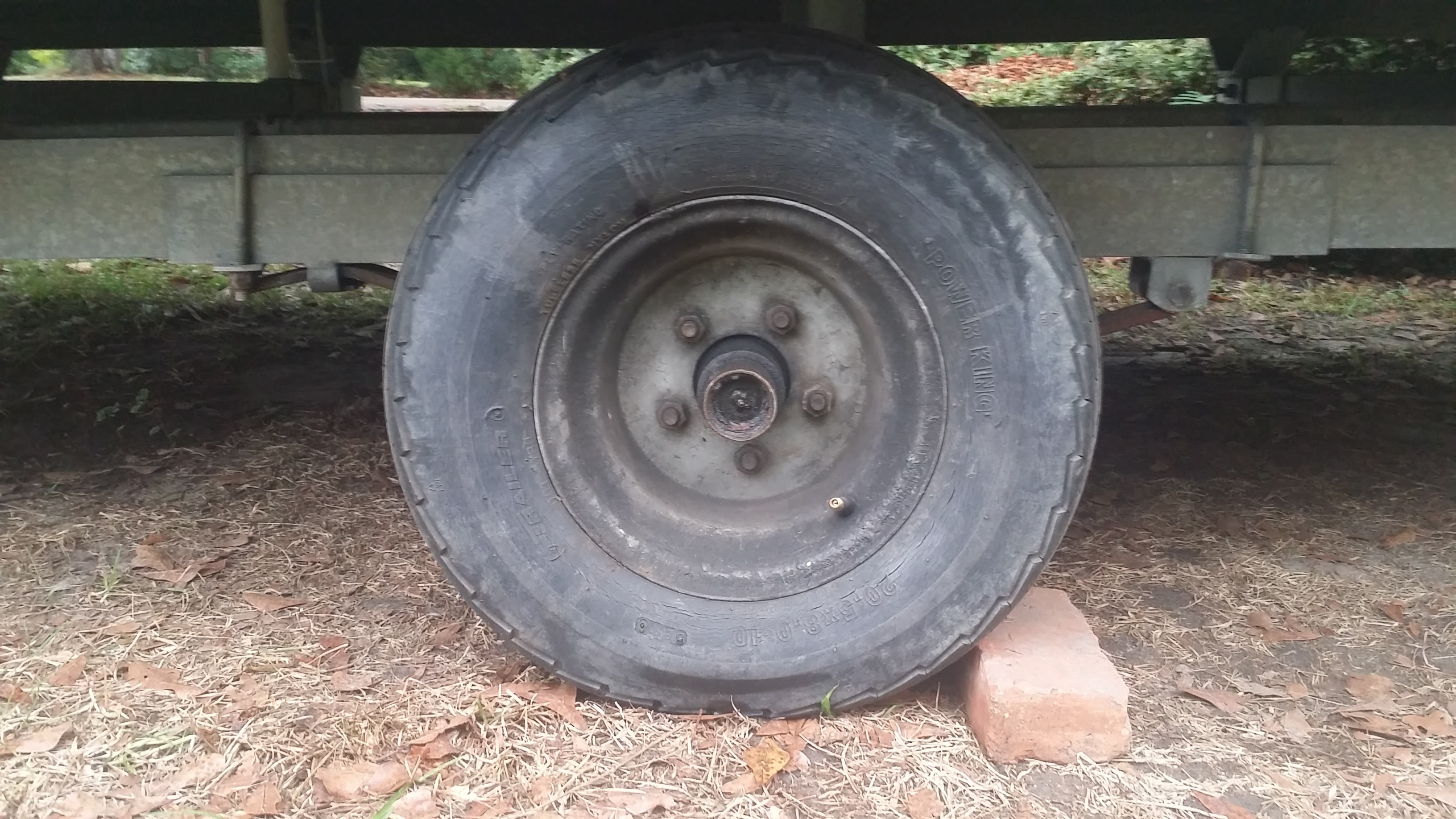

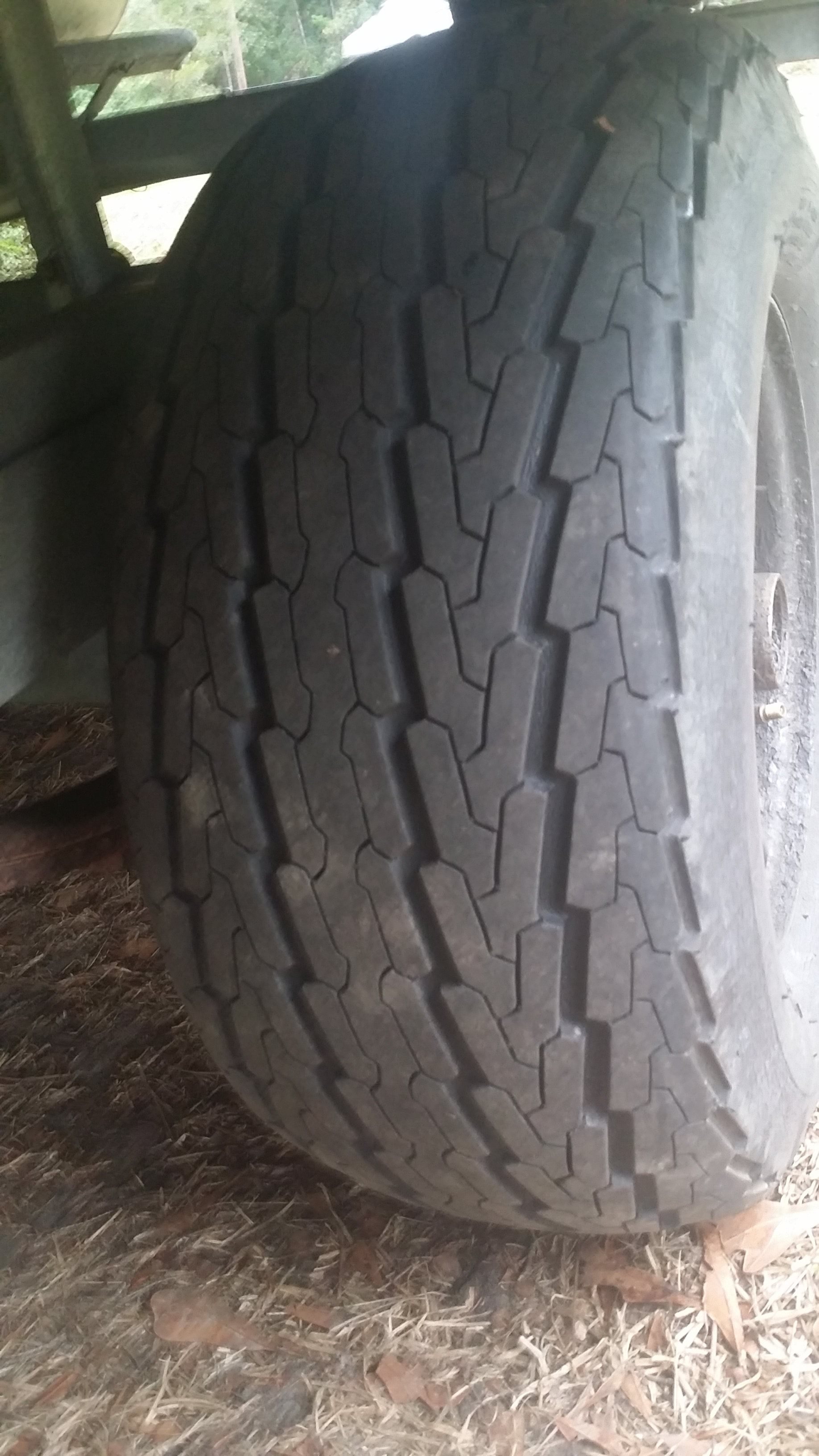

Hey everybody,
I am looking to get new trailer tires. The ones on there now are Power King 20.5 X 8.0 – 10. I am unsure of the age because they were on their when I bought it this summer but they look pretty rough. I am pulling a 1992 Bass Tracker 18. The furthest I will be driving is approximately 1.5 hours away and this will only be occasionally. Can anyone provide input on what tires I should get? Ply or Radial, stay with that size or change it?
Thanks!!

Whatever you decide, looks to me like you store your boat in the weather. You have plenty of tread left but your side walls are trashed, might want to try some tire covers.
