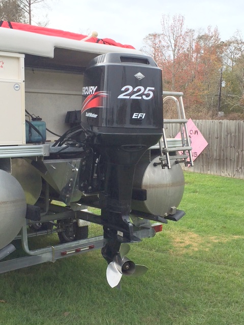

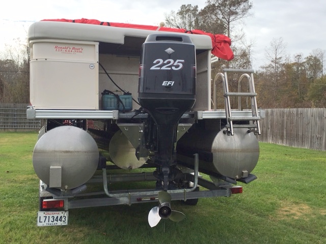

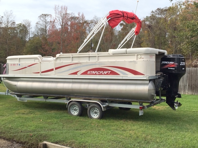

Hi, I am new to here but not the boating community, I have a 25' Baja and a 18' bay boat too. I purchased my Pontoon boat from my friend a few years back it is a StarCraft 223 limited. It had 2 toons on it and after taking a few waves over the bow and almost flipping it in the lake when rough weather popped up. " see pictures lol... I wanted to upgrade, So I added a 3rd pontoon and pulled that 115 optimax off of it and picked up a Mercury 225. I am still dialing it in but I am running 45 on a gps so far but the motor height needs to be adjust on the jack plate, the prop needs to be changed and I need to see about adding lifting strakes. Does anyone here know where I can buy them online and order them? or all of them custom made? anyway Just thought I would let everyone see my build and my project in the the works and get a few opinions, it's a little dirty as we were in it all Thanksgiving weekend... Living down in South La. sucks in the summer but it sure is nice the rest of the year. We can boat all year and there is only a month or two that it's too cold!!! :nana :nana

With 2 pontoons i could never ger the front end up even trimmed up and everybody in the back. The solution was to add the 3rd pontoon.. What a difference that made.. Its like night and day. Just putting the 3rd toon on it I picked up 8 mph and the front end rides high. It handles like a boat now instead of a barge

Bennington's using strakes on their Express center tube--like you've got. And they run just as fast as their full third center tube--but may give a little up in handling.
I would tell you to drop the center toon and have a high quality certified welder add strakes to just it. And I would suggest you find a Bennington and copy their strake design--angles, width, gauge, length.
