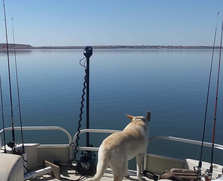

Re: 45" Inch ipilot trolling motor
Posted: Sat Jan 30, 2016 12:36 pm
by mzodarg
So there was no way to put 2 27 series batteries side by side, but this worked.
Also got the 80# IPilot mounted, I used the quick disconnect that was suggested here. Worked like a charm.
Posted: Mon Feb 01, 2016 3:12 am
by mzodarg
Few more shots:
