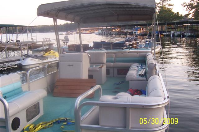

We think we found why our hard top is rocking so much. There seems to be a brace missing on the back, anyway there are some empty holes where it looks like a brace should go.

our hard top bolts to the railings and rock a LOT so i used "very small" cable in a big V from the top outer corners to the middle of the floor behind the rear gate, then i used 2 small turn buckles to tighten the cables and no more shake or rock. the cables are hard to see.... and the way they are set up when i fold the top down they just lay faward and i dont have to do anything with them :)

We had a hardtop on an old '86 toon that rocked like crazy. I used some flat metal and clamps to gusset the top and removed a lot of the movement.

here is the cables i used for mine. (i lower the top on mine to trailor it) so i needed somthing simple :)
here you can barely see them
here it is close up
and it is solid as a rock now, i can tighten the turn buckles if the cable streches any

My husband looked closer and found all the bolts just needed to be tightened down more and replaced under the side! He also looked at the guy's that posted on here and rigged up a similar
contraption. It does a whole lot better.
