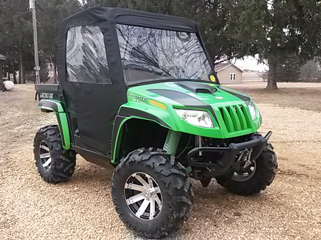

I use Mobile 1 in everything except the Prowler. I use cheap synthetic wet clutch oil in it and cheap JAP filters, because its changed every 20 hours. It gets a real pounding and see's some high clutch temps! But the oil always dumps clean.
- 20160229_155034.jpg (223.25 KiB) Viewed 7874 times
