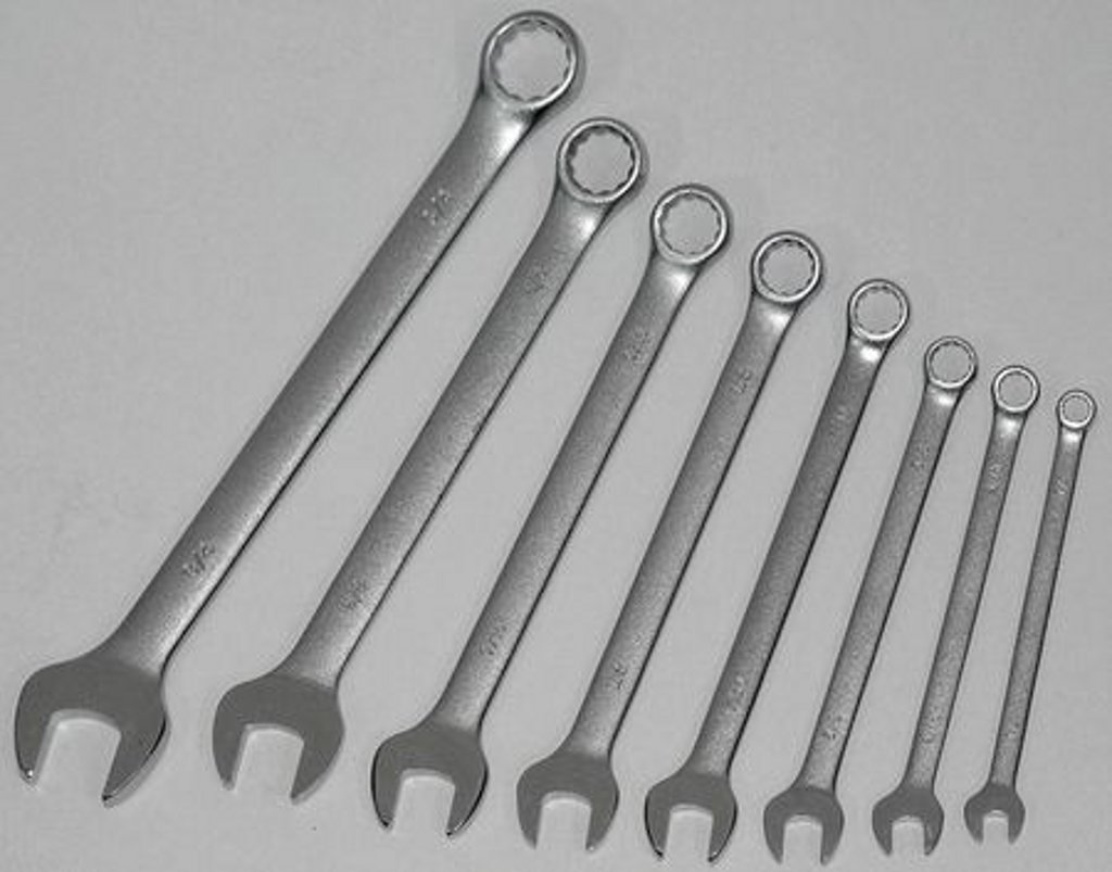

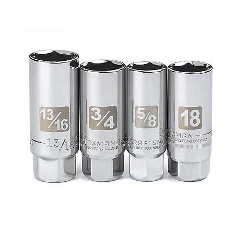

I use a socket that has a hex on the back and a box end wrench on the hex

this may help Jim
this sort of spark plug socket has a hex end and you can fit a standard box end wrench on it, it works very well in a close space, how ever it will take a bit of time to work out a plug, but it works
box end.JPG (83.05 KiB) Viewed 1419 times
plug socket.jpg (73.92 KiB) Viewed 1419 times
