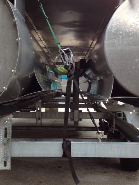

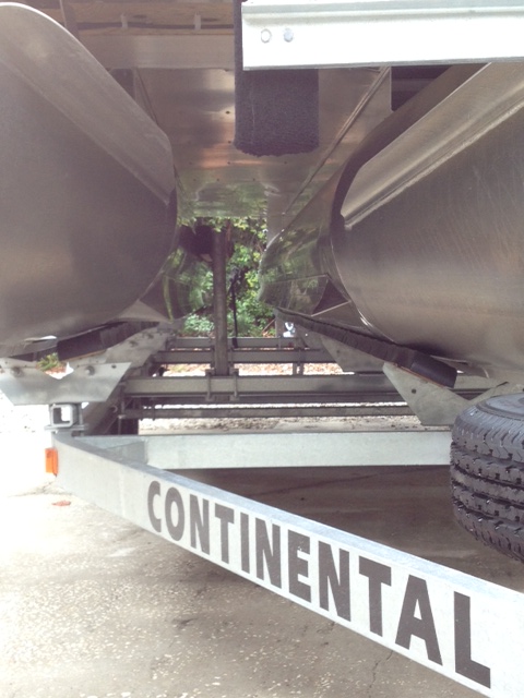

Here's what I did, works great.

Where did you order the guides? That looks like exactly what I need. I don't want to damage my strakes and what you have there appears to guide above them.

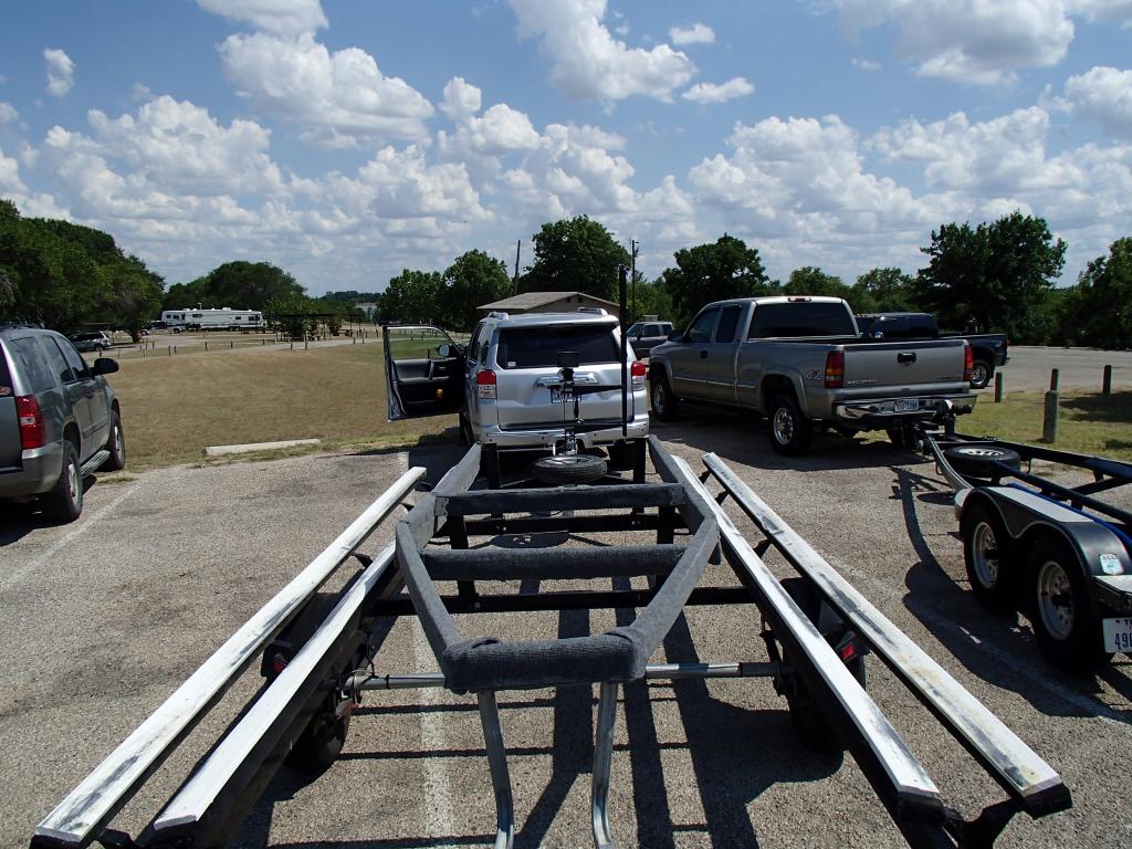

Here is a couple of pics of what I did, hope it helps someone like it did me-
- Trailer loading.jpg (152.8 KiB) Viewed 19531 times
- trailer loading help 2.jpg (177 KiB) Viewed 19532 times
Re: Trailer Guides
Now I like that!! I did take mine out today with the "modified" post. Really help as I could see the post. Slid right on and centered it perfect. If I ever have the want or need to modify from post, I will certainly look hard at that set-up! Good job!!

So I like what you have on your trailer BUT - aren't you afraid of that bare metal post facing the inside of the center log of the tritoon? I can see that causing damage unless you are lined up exactly straight. I see that overtons has these center posts but they are round and have pvc pipe on them that will rotate if the toons touch. Anyone tried them?

Trying to get a pontoon/tritoon back on the trailer is reason of concern when the conditions are not exactly perfect. And they're especially a handful when you're trying to load the trailer by yourself. It's nice not to have any laws prohibiting powering the boat on to the trailer.
The above posts guides are what you don't want to use on a pontoon boat. They'll dent your toons in some situations, especially on windy days.
