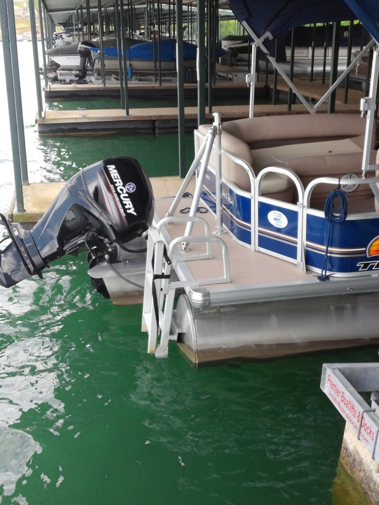

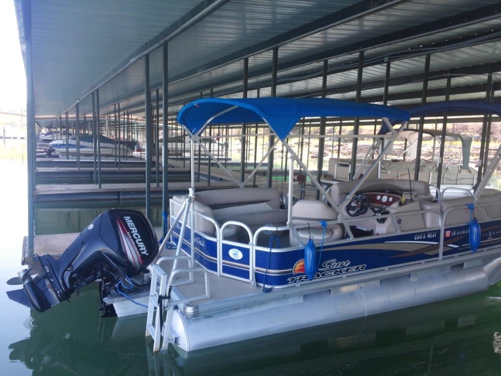

Keep in mind that all boat/motor combo are different some may only be able to clear the water by a little bit, some may not clear the water at all and yet some lift full clear. My friends HONDA will not quite clear all the way as the motor is just big boned for his boat...urbnsr wrote:Thanks everyone. I always appreciate your step-by-step procedures because I will probably mirror them, too. I went and raised the motor all the way - Completely out of the water. Then I looked down the line and of the ones raised at all, they were only raised enough to get the prop out of the water. I'm new here and have not seen these other boats out on the lake as of yet - I suppose the hydraulic lift can drift down in time? Or maybe they are only concerned for the prop and consider the rest of the lower housing is simply cosmetic (thinking about growth)?
The only time a trim/till will drift if if it leaks by or leaks out and either way that is another problem to deal with but is also very rare.
Much more than cosmetic when you have Zebra Mussels growing inside your foot and fowling your water intake and/or ruining your motor due to overheating....
- clean and wet.jpg (122.48 KiB) Viewed 5788 times
- old clear.jpg (235.79 KiB) Viewed 5788 times
Re: Tilt Motor Up Or Down While Docked In Season?
Notice two completely different motors? Both tilted out all the way but each look different due to overall size and weight too as one motor is a hundred pounds heavier so she sits deeper in the water...urbnsr wrote:Good points. Nice pictures!
