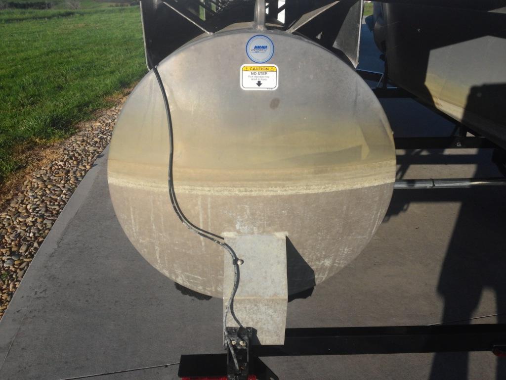

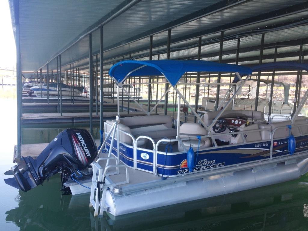

Re: ACID WASH - NAPA ALUMINUM BRIGHTNER
Overall I was pleased with the results with such little effort...
- before aft.jpg (96.81 KiB) Viewed 9552 times
- clean and wet.jpg (122.48 KiB) Viewed 9551 times
teecro wrote:Overall I was pleased with the results with such little effort...
Looks great!
The downside is that that black film is actually oxidation that forms a protective barrier to prevent further corrosion and oxidation on the toons. Technically every time you acid wash you are making the aluminum a little bit thinner. That being said, it looks great and is easy. My grandfather's boat is 25 years old and gets acid washed every year or every other year with no issues yet to date.
