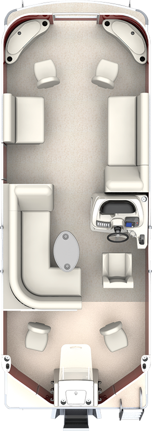

I do have two 27" tubes and lifting strakes. I don't think that my dealer will play around for best results.
I'm told my problem has been the layout . All the weight is mid ship and forward.
Even the two forward chairs are the custom captain style.
Sweetwater did not realize they had a problem with the first roll off of 27" tubes, and I've been stuck waiting for solution.
I'm told upgrading will do it. Getting full credit for my motor, but still it's costly, and unfair.
I just want to get her running right and reliable. I'm tire of cursing every time I exceed 3900 rpms.
If I get 36 mph I'll be happy, and 38 I'll be super happy.

I don't understand the long shaft, short shaft issue. Every pontoon I know of uses the long shaft motors.
Bennington and other manufacturers used to modify the motor mounts when the Yamaha SHO was mounted from the factory, however that's because the SHO's only came in the short shaft (as used on bass boats) at the time. And I promise you SHO motors get a serious dousing of water everytime they go out.
Short shaft motors on pontoons will always have ventilation problems, especially when 3-4 people sit in the front end--thus lifting the engine and the rear end a few inches. (I'm a victim of this problem on my old boat.)
Another thing i don't understand is the dealer not wanting to optimize performance on your boat. That's his job. An unhappy owner results in many friends that won't buy from that dealer.
Why don't you call customer service at the boat manufacturer to see which motor and propeller they spec. for your specific hull?

I think it will make a big difference, the 27"ers must be heavy so maybe the extra (200LBS?) of the 150hp will help lift the bow along with the added power.
