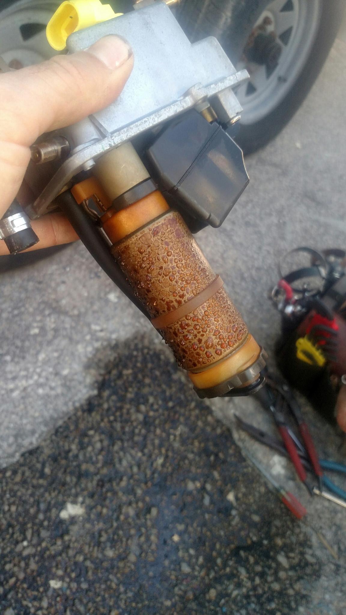

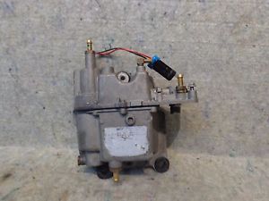

#10 Post by FLOUNDERPOUNDER225 » Tue May 28, 2019 7:10 am
Here is the problem, this one was from ethanol fuel that had sat for a long time, gathered water and corroded everything in the VST (Vapor Separator Tank) that's where the pmp and float are located.
vst pump.jpg (234.98 KiB) Viewed 5378 times
vst mercury.jpg (12.22 KiB) Viewed 5378 times
