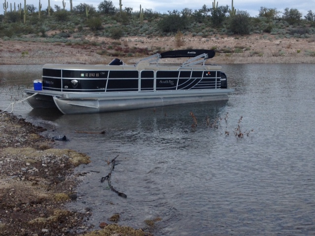

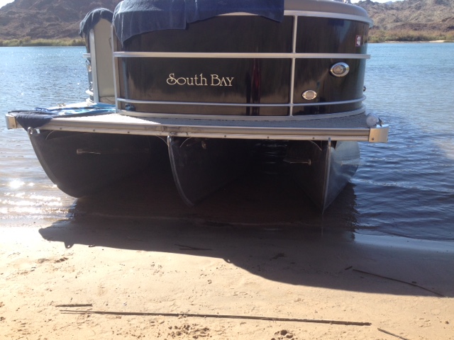

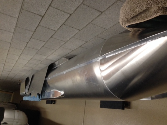

Well I got it all done and I'm happy with the results.
I gained 3-4 mph and the ride is great.
I ended up installing it myself so that saved me $1,100.00.
It took some time but it was a fun job and turned out great.

Here's a couple pictures.

Congrats! and thanks for the update!
Does your side pontoons have lifting strakes?
What was your initial top speed and current top speed?

Lifting strakes on the insides of the outer tubes.
Lifting strakes on both sides of center too.
When from 25 mph loaded to 28.5 mph loaded.
