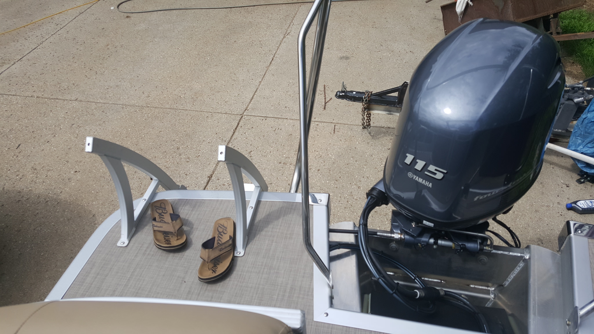

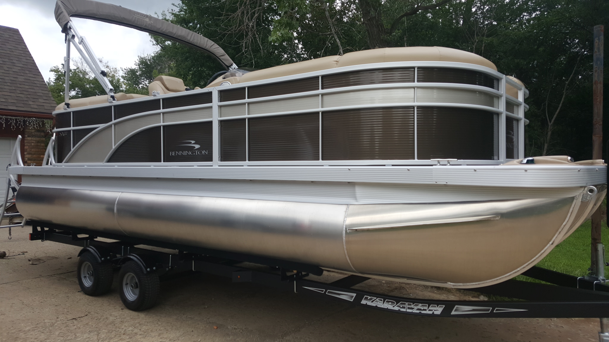

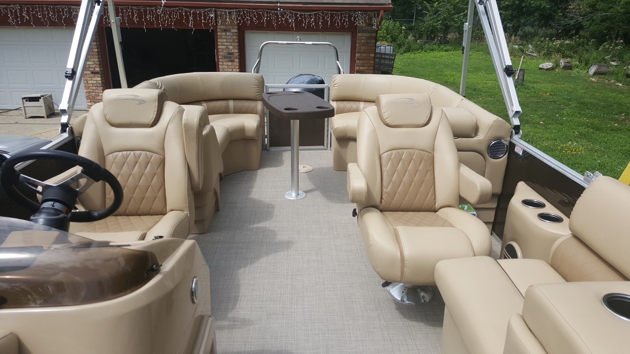

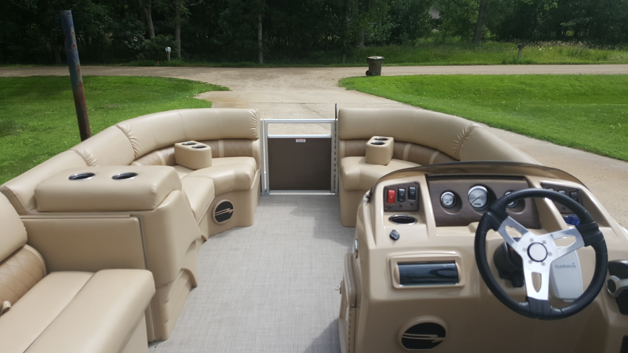

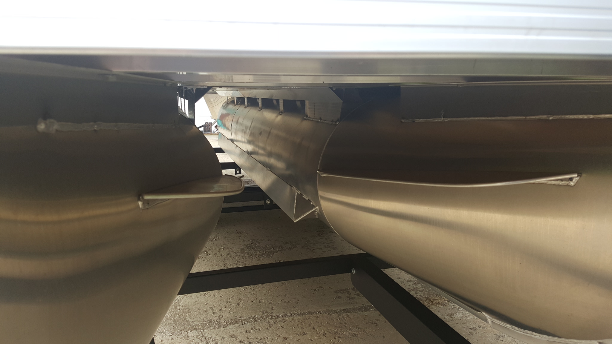

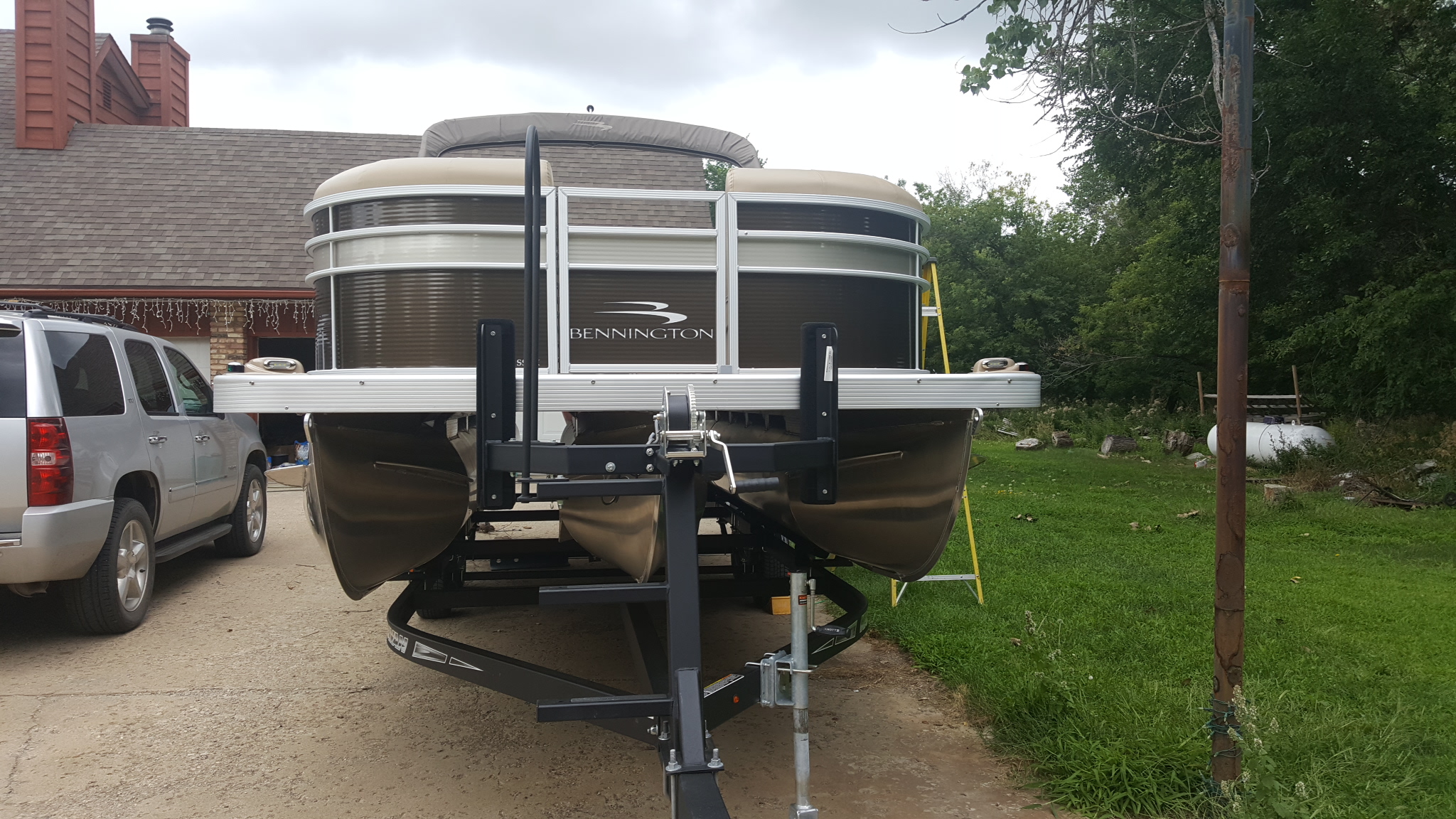

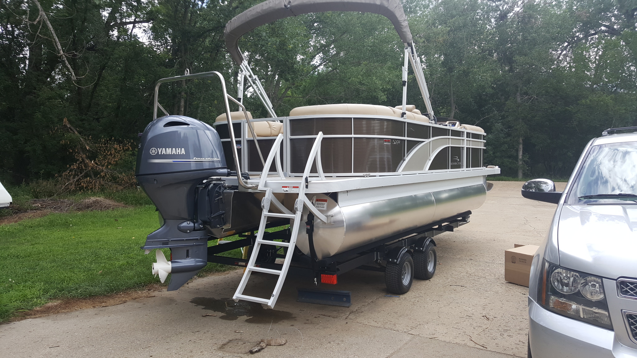

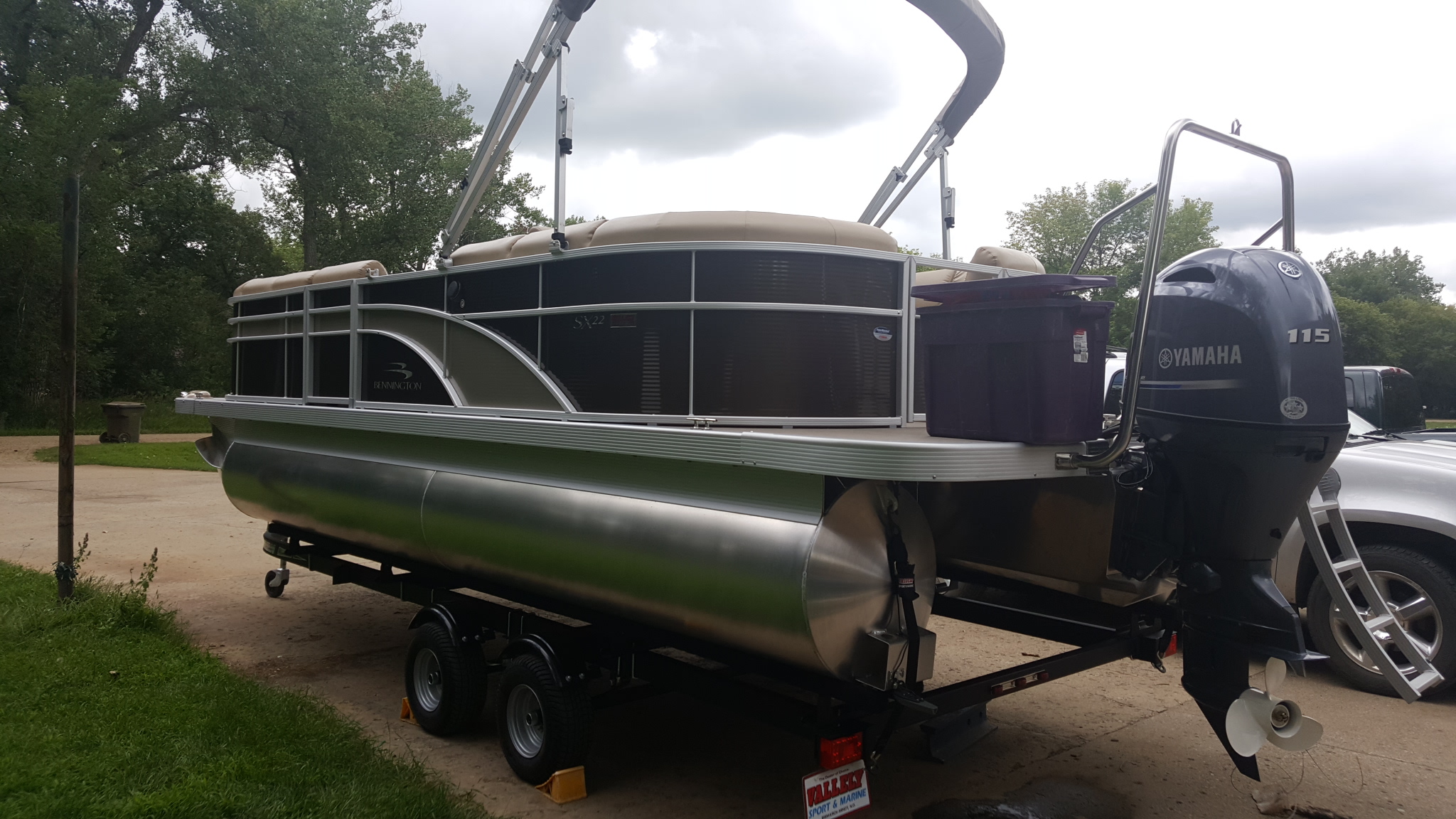

just got done 303ing the seats, yes roland I traded the 2009 2075 gli benny for the 2017 22ssrx benny. this one has the 3 sport tube its only 3/4 long with strakes. 25 inch tube and powered by a 115 hp Yamaha four stroke. It hasn't hit the water yet I am just getting everything loaded and figuring out where to stow everything.

#6 Post by tkrein » Wed Jul 27, 2016 10:54 am
more pics

Beautiful boat

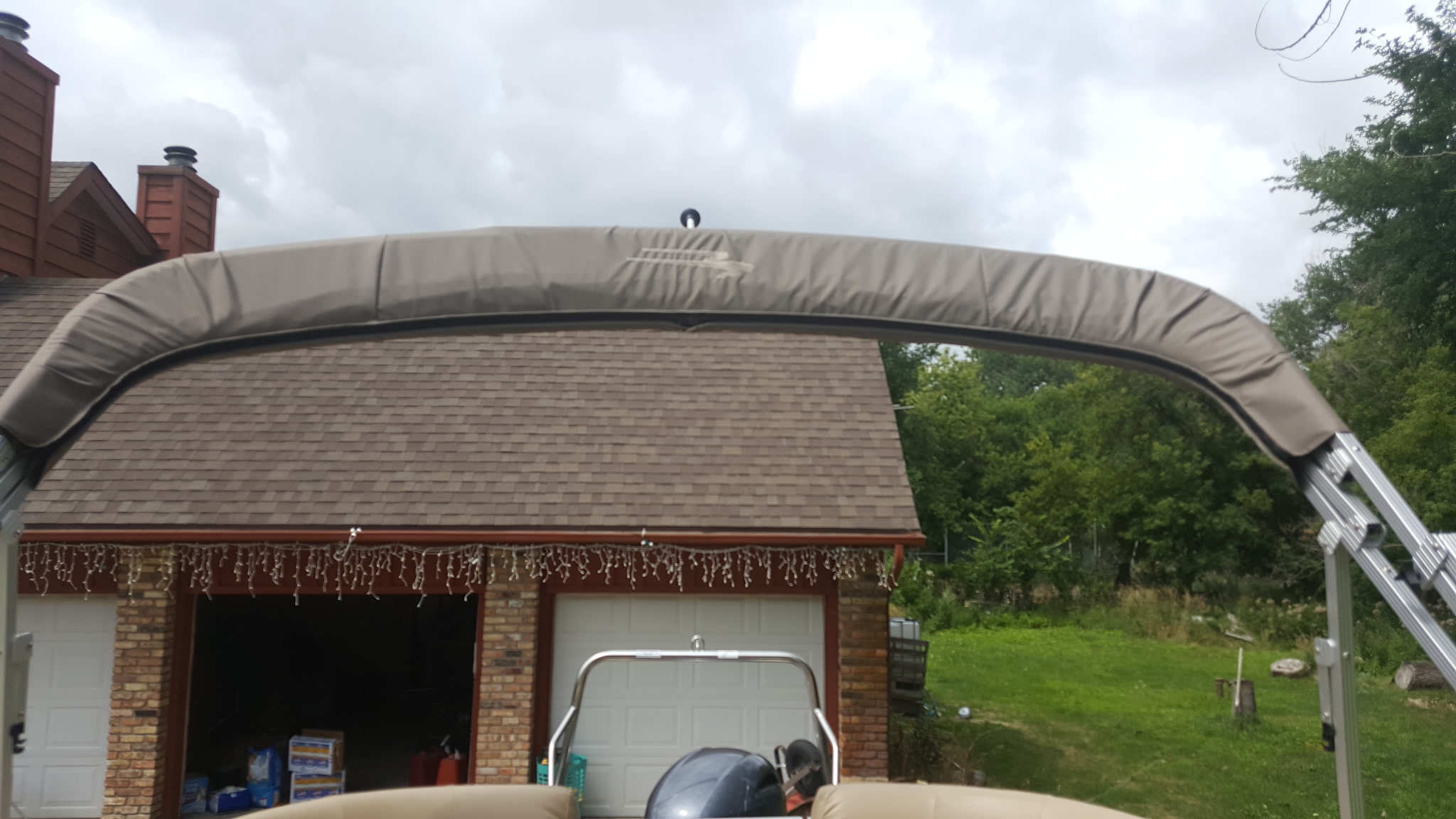

Time to take the Christmas lights down

lakerunner wrote:Time to take the Christmas lights down
nah... they just put them up to illuminate their new toy!

O the lights yes they are a very elaborate setup. I'll link my video to them.

The motor is a 115 hp

Tk... congratulations again.. that is one good looking toon... and as you already knew, you can't go wrong with a Benny.... not a single issue with mine and we've had it going on 7 years...

Roland I agree, but the boys are older and want to go faster. Got the 2 hour break in done. So the manual said I could go full throttle just not for longer than 5 minuets I tried I could only top out at 5000 rpms 5he manual says it should hit 6300. No where close 3 adults 2 kids a cooler gonna stop at the dealer on Monday and ask what's up it also cavitates anything more than 1/2 tilt the motor is on the last hole. Any suggestions that I can tell the dealer.

TK....when my boat was new she would run 6100-6200 rpms.... dinged up the prop one year and the benny dealer talked me into getting a different pitch prop.... on the new prop never would rev over 5000 rpm.... called Yamaha and they said I needed to go back to the original pitch prop ( don't remember off hand what pitch that is )... did what they said... still getting right at 6K rpms at wot.... with my 75 hp that comes out to about 23 mph with no headwind and a perfectly smooth lake..... anyway.. love the look and color of your new benny...
