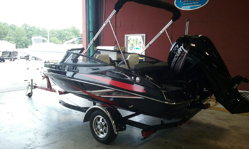

For this reason I wanted a Mercury on our new bow-rider so that even one of my spare pontoon props could be used as a get home spare on the little black bug...Bamaman wrote:The deal is that the Suzuki prop shafts turn so slow. No other motor's setup that way. It takes a lot of pitch to push the boats.
I just like the fact that there are so many Yamaha and Mercury mechanics that have setup their more popular motors on pontoons/tritoons. It's so much easier to figure out how to prop their engines, etc.--if just by experience.
