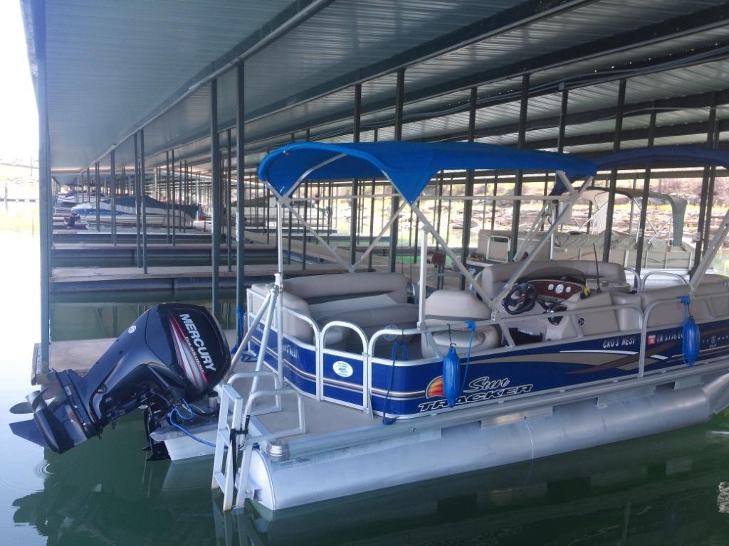

Even though I grew up on the bayous of LA with my Father three years ago I would have never so much as entertained the idea of purchasing a boat much less 2 of them... I've worked on boats (550-ft) for closest to 30 years and wanted nothing to do with water while I was off from work. We moved to a lake view home in TN and today I can not wait to get home to the jadeite green waters, crack open a bottle of beer and go get me some marina food...
