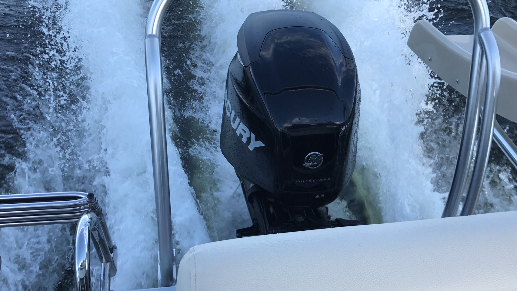

Here is a picture under power at optimal trim and ~25mph. Does it look like it is plowing to you guys?

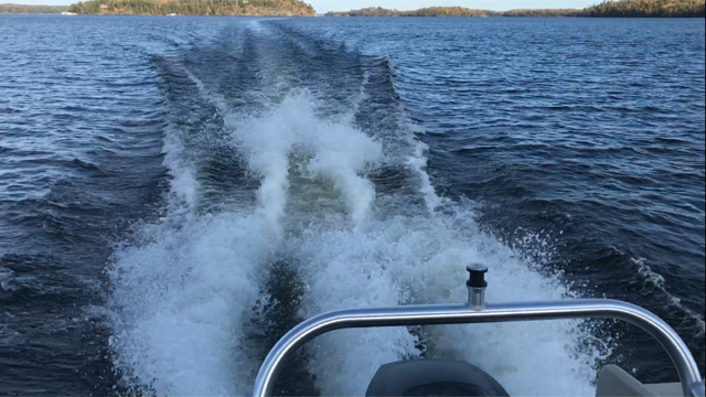

Sorry, but the plowing they're talking about is not at the rear--it's the front of the toons plowing thru the water.
Most tritoons with strakes and the engines trimmed up will have the water breaking 3-4' behind the back of the nosecone seamss. They essentially "fool" the hull into getting up on top of the water vs. displacing the water by plowing through it.
Are you trimming the engine as high as it can go without ventilation happening?
When throw the throttle to my boat when trimmed out, at about 30 mph I can feel the front end actually lift a few inches. My 40 mph speed comes from getting those nosecones out of the water.

Well... I feel like an idiot for thinking it was at the rear! I've seen it mentioned that moving the motor up or down a few holes on the mount can help. I have the nose trimmed up as far as I can before the motor starts to ventilate (starts hitting the rev limiter at 6400 and speed slows down).
When stopped, the boat tends to sit quite heavy at the rear. I'm assuming this is due to the weight of the upper deck and slide which are at the back of the boat. It never feels like it's plowing at the front.

I'm sure this likely won't help either, but on the off chance it does... This is the wake behind the boat.
