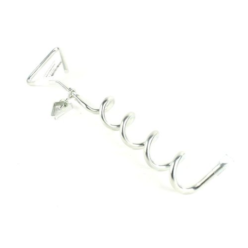

I use two screw tie downs (meant for dogs from the dollar store) off the front with harbor freight quick pull strap tie downs. No knots to tie just hook on each end. Also I tell the ballast (wife and kids) to go to the back of the boat when beaching. Worked great for 20 plus years. We put a foot tub with water off the front to rinse your feet for the people that insist on getting on from the front. When we leave I put the tie downs and strap in the tub.
